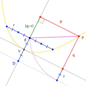

Suppose point $P$ on a parabola with focus $F$ and latus rectum $4r$ has distance $p$ from the axis and distance $q$ from the vertex-tangent.
Then $\overline{PF}$ is the hypotenuse of a right triangle with legs $p$ and $|q-r|$; also, $P$ is at distance $q+r$ from the directrix. These distances are equal for a parabola, so we can equate their squares:
$$p^2+|q-r|^2 = (q+r)^2 \qquad\to\qquad p^2=4r\cdot q \tag{1}$$
