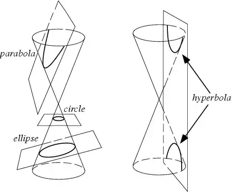

The theory of Conic Sections stems from ancient times. It is an example of pure mathematics, which has found applications only many centuries after it has been developed, e.g. with the laws of planet motion as discovered by Johannes Keppler. But, interesting as it is, we shall leave aside history and immediately come to core - or rather cone - business.
The problem is to intersect a circular cone with a plane and determine the curves of intersection, like shown in the above picture. This could be done in the way the old Greek mathematicians did it. But we prefer to take a path that requires less ingenuity and we shall employ the means of modern analytical geometry instead. With such an approach, though, one should be prepared for tedious algebra when working out the details.

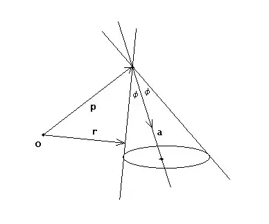

A circular cone is characterized by the fact that the angle $\phi$ between the cone axis and its surface is a constant. Let the unit vector $\vec{a}$ be the direction of the cone axis and let $\vec{p}$ point to the top vertex of the cone. An arbitrary point at the surface of the cone is pinpointed by $\vec{r}$. Then the following is an equation of the cone surface: $$ (\vec{a}\cdot\vec{r}-\vec{p}) = |\vec{a}||\vec{r}-\vec{p}|\cos(\phi) $$ Square both sides: $$ (\vec{a}\cdot\vec{r}-\vec{p})^2 = (\vec{a}\cdot\vec{a})(\vec{r}-\vec{p}\cdot\vec{r}-\vec{p})\cos^2(\phi) $$ And work out: $$ (\vec{a}\cdot\vec{r})^2 - 2(\vec{a}\cdot\vec{p})(\vec{a}\cdot\vec{r}) + (\vec{a}\cdot\vec{p})^2 = \cos^2(\phi) \left\{ (\vec{r}\cdot\vec{r}) - 2(\vec{p}\cdot\vec{r}) + (\vec{p}\cdot\vec{p})\right\} $$ The unit vector $\vec{a}$ can be written as: $$ \vec{a} = \left[ \cos(\alpha)\cos(\gamma),\cos(\alpha)\sin(\gamma),\sin(\alpha)\right] $$ Where $\alpha$ is the angle between the cone axis and the XY-plane and $\gamma$ is an angle that indicates how the conic section is rotated in the plane. The vector of the top of the cone can be written in its coordinates as: $$ \vec{p} = (p,q,h) $$ Where $h$ is the height of the cone above the XY plane and $(p,q)$ indicates how the conic section is translated in the plane. Last but not least, the vector pointing to the cone surface is written as: $$ \vec{r} = (x,y,z) $$ Where the intersections with the XY plane are found for $z = 0$. Let's do just that and work out the above: $$ \begin{cases} (\vec{a}\cdot\vec{r}) &=& \cos(\alpha)\cos(\gamma)\,x + \cos(\alpha)\sin(\gamma)\,y \\ (\vec{a}\cdot\vec{p}) &=& \cos(\alpha)\cos(\gamma)\,p + \cos(\alpha)\sin(\gamma)\,q + \sin(\alpha)\,h \\ (\vec{r}\cdot\vec{r}) &=& x^2 + y^2 \\ (\vec{p}\cdot\vec{r}) &=& p\,x + q\,y \\ (\vec{p}\cdot\vec{p}) &=& p^2 + q^2 + h^2 \end{cases} $$ Collecting powers of $x$ and $y$ results in: $$ A\,x^2 + B\,xy + C\,y^2 + D\,x + E\,y + F = 0 $$ Where: $$ \begin{cases} A &=& \cos^2(\phi) - \cos^2(\alpha)\cos^2(\gamma) \\ B &=& - 2 \cos^2(\alpha)\cos(\gamma)\sin(\gamma) \\ C &=& \cos^2(\phi) - \cos^2(\alpha)\sin^2(\gamma) \\ D &=& 2 \left\{ \cos(\alpha)\cos(\gamma) (\vec{a}\cdot\vec{p}) - \cos^2(\phi)\,p \right\} \\ E &=& 2 \left\{ \cos(\alpha)\sin(\gamma) (\vec{a}\cdot\vec{p}) - \cos^2(\phi)\,q \right\} \\ F &=& (\vec{p}\cdot\vec{p}) \cos^2(\phi) - (\vec{a}\cdot\vec{p})^2 \end{cases} $$

The first three coefficients of the conic section equation are: $$ \begin{cases} A &=& \cos^2(\phi) - \cos^2(\alpha)\cos^2(\gamma) \\ B &=& - 2 \cos^2(\alpha)\cos(\gamma)\sin(\gamma) \\ C &=& \cos^2(\phi) - \cos^2(\alpha)\sin^2(\gamma) \end{cases} $$ All kind of conics can still be produced if the angles $\phi$ and $\alpha$ are limited to sensible values: $$ \begin{cases} &&0 < \phi < 90^o \quad \Longrightarrow \quad 0 < \cos(\phi) < 1 \\ &&0 \le \alpha \le 90^o \quad \Longrightarrow \quad 0 \le \cos(\alpha) \le 1 \end{cases} $$ Generality is not affected by these choices. Moreover it is seen from the picture below that the form of the conic section is determined by the angles $\phi$ and $\alpha$ and nothing else. Therefore the ratio of the two angles will be defined here as the excentricity ($\epsilon$) of the conic section: $$ \epsilon = \frac{\cos(\alpha)}{\cos(\phi)} $$ The following relationships exist between the excentricity and the form of a conic section, as is clear from the picture: $$ \begin{cases} \mbox{Circle : }& \alpha = 90^o &\quad \Longleftrightarrow \quad \epsilon = 0 \\ \mbox{Ellipse : }& \alpha > \phi &\quad \Longleftrightarrow \quad \epsilon < 1 \\ \mbox{Parabola : }& \alpha = \phi &\quad \Longleftrightarrow \quad \epsilon = 1 \\ \mbox{Hyperbola : }& \alpha < \phi &\quad \Longleftrightarrow \quad \epsilon > 1 \end{cases} $$ enter image description here

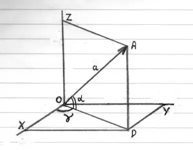

EDIT. Explanation of $$ \vec{a} = \left[ \cos(\alpha)\cos(\gamma),\cos(\alpha)\sin(\gamma),\sin(\alpha)\right] $$ enter image description here
See picture. Overline denotes " length of " in: $$ \overline{OZ}=\overline{OA}\, \sin(\alpha) \quad ; \quad \overline{OD}=\overline{OA}\, \cos(\alpha) \\ \overline{OX}=\overline{OD}\, \cos(\gamma) \quad ; \quad \overline{OY}=\overline{OD}\, \sin(\gamma) $$ With $\overline{OA}=1$ .

  • Your answer is excellent but I couldnot follow it until last.I was stumped at how you expressed $\vec{a}$ in terms of various angles in the first para under Analysis section.If its possible please give a bit more explanation otherwise I might have to wait till i become more mathematically mature.Thanks. – Navin Jan 27 '17 at 11:18
  • @navinstudent: I've made an EDIT to the answer. Hope it helps. – Han de Bruijn Jan 27 '17 at 13:36

  • Your edit was helpful and i could follow it till last.Thanks a lot. – Navin Jan 27 '17 at 17:30

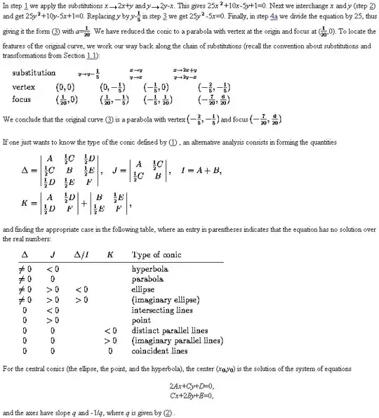

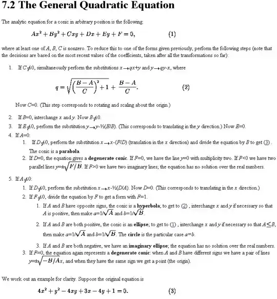

Perhaps you'll find helpful this discussion from CRC Standard Mathematical Tables and Formulas. See also the Wikipedia page on degenerate conics.
Bill Dubuque
