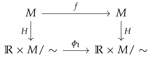

  4. In dynamics literature typically $C^r$ conjugacy between two actions $\alpha_\bullet:G\to \operatorname{Diff}^r(X)$ and $\beta_\bullet: G\to \operatorname{Diff}^r(Y)$ refers to a $C^r$ diffeomorphism $H:X\to Y$ such that for any $t\in G: H\circ \alpha_t=\beta_t\circ H$. So the underlying manifolds ought to be of the same dimension. But
$$\dim(\mathbb{R}\times M/\sim)=1+\dim(M),$$
as you stated, so $\phi_1$ is not $C^r$ (nor $C^0$) conjugate to $f$.
If we only require $H$ to be a $C^r$ map (not necessarily with an inverse), then $\alpha_\bullet$ is said to be $C^r$ semi-conjugate to $\beta_\bullet$. In this situation, $f$ is indeed $C^r$ semi-conjugate to $\phi_1$. To see this first note that we need a $C^r$ map $H: M\to \mathbb{R}\times M/\sim$ such that $H\circ f=\phi_1\circ H$:
To find such an $H$ first note how $\phi_1$ acts on $\mathbb{R}\times M/\sim$:
$$\phi_1([s,x])=[1+s,x]=[s+1,x]=[s,f(x)],$$
that is, even though $\phi_\bullet$ descends from a "horizontal" flow (and this adjective indeed has significance), its time-$1$ map acts "vertically" (no matter what $s$ is chosen). So putting $H(p)=[s_p,x_p]$, we need $H$ to satisfy
$$[s_p,f(x_p)]=[s_{f(p)},x_{f(p)}].$$
I hope this much is enough for you to find such an $H$ (in this case there are many choices; for a general group action there is only one guaranteed by construction).
