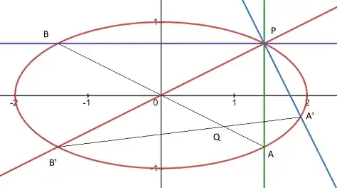

My idea would be to simplify the working. The question does not ask us to prove that the chords pass through the same point $Q$. It states that if they do, what is the coordinates of $Q$. So if they do pass through a common point $Q$, its coordinates can be found using any such two chords.
Given eccentric angle of $\frac{\pi}{4}$, coordinates of $P$: $\left(\sqrt2, \dfrac{1}{\sqrt2}\right)$
So if we take the first pair as a horizontal and a vertical line,
Coordinates of $A$: $\left(\sqrt2, -\dfrac{1}{\sqrt2}\right)$
Coordinates of $B$: $\left(-\sqrt2, \dfrac{1}{\sqrt2}\right)$
Equation of line $AB$ turns out to be $x+2y = 0 \ \ $ ...$(i)$
Now you have two approaches you can follow,
you can show using the answer to one of the questions you linked (link) that the normal line at $P$ will pass through point $Q$. That makes it easier to find the coordinates of $Q$.
Or just take point $B'$ as $\left(-\sqrt2, - \dfrac{1}{\sqrt2}\right)$ so slope of line $PB'$ is $ \dfrac{1}{2}$.
Hence equation of line $PA'$ will be,
$\left(y - \dfrac{1}{\sqrt2}\right) = -2 (x - \sqrt2) \implies 2x + y = \dfrac{5}{\sqrt2}$
Plugging it into equation of ellipse, you get the coordinates of $A'$ as $\left(\dfrac{23\sqrt2}{17}, -\dfrac{7}{17\sqrt2} \right)$.
That leads to equation of line $A'B'$ as,
$ y + \dfrac{1}{\sqrt2} = \dfrac{1}{8} (x + \sqrt2) \ \ $ ...$(ii)$
Solving $(i)$ and $(ii)$ should give you coordinates of $Q (a, b)$ and you should get to the final answer of $m + n = 19$.

A better approach to this question would be, to take two perpendicular chords from √2 , 1/√2.
diagram(not able to embed it)
At the first thought you would PA and PB as the perpendicular chords and get an equation of line AB: x+2y=0
The other line to take might seem confusing at first but give it a thought,
The tangent at any point is the limiting case of a chord, so if we take point P and a point just next to it, the tangent is the chord. The perpendicular chord would obviously be the normal.
So the two points should be the point just next to it and the other end of its normal chord, the equation of the points joining is again the normal, So technically, we can say point of intersection of normal at that point and the AB is the answer.
Solving should give you coordinates of Q(a,b) and you should get to the final answer of m+n=19
