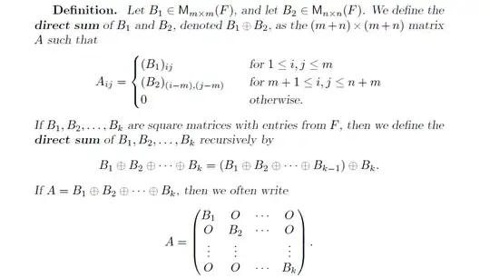

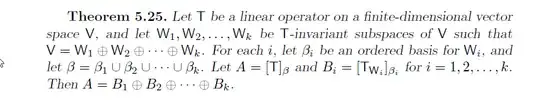

Prior to attempting to prove the question I have two relevant pieces of information to use:

Let $\beta_{i}$ be an ordered basis for $W_{i}$ such that $\beta = \cup \beta_{i}$ is a basis for $V$. As such we let $A = [T]_{\beta}$ and $B_{i} = [T_{W_{i}}]_{\beta_{i}}$.
As a result of this $A = B_{1} \oplus B_{2} \cdots \oplus B_{k}$. Observe $A$ is a diagonal matrix. As a result $\det(A)$ is the product of the diagonal.
$$\det(A) = \prod_{i = 1}^{k}B_{i}$$
