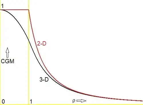

The numerical experiments give rise to the following conjecture (contradictory on purpose): $$ \operatorname{CGM}(\rho) = \begin{cases} 1 & \mbox{for} \quad \rho \le 1 \\ 0 & \mbox{for} \quad \rho = 1 \\ \rho^2 & \mbox{for} \quad \rho \ge 1 \end{cases} $$ Is there someone who can prove this conjecture analytically?
I have seen something with complex analysis in sci.math a long time ago (2008) but didn't quite understand the argument.
CGM for a Sphere
In view of further development of the theory, it seems to be advantageous to define the Continuous Geometric Mean slightly different, namely as: $$ \operatorname{CGM}(\vec{r}) = \exp\left(- -\!\!\!\!\!\!\int_0^1 \ln(\left|\vec{p}(t)-\vec{r}\right|^2)\,dt\right) $$ For our unit circle (with Cauchy principal value) then we have instead: $$ \operatorname{CGM}(\rho) = \begin{cases} 1 & \mbox{for} \quad \rho \le 1 \\ 1/\rho^2 & \mbox{for} \quad \rho \ge 1 \end{cases} $$ We seek to generalize the Continuous Geometric Mean for a circle to the same for the surface of a unit sphere: $$ \operatorname{CGM}(\vec{r}) = \exp\left(-\iint \ln(\left|\vec{p}-\vec{r}\right|^2)\,dA/(4\pi)\right) $$ Expressed in spherical coordinates and specializing (without loss of generality) for $\,\vec{r} = (0,0,\rho)\,$: $$ \vec{p}-\vec{r} = \begin{bmatrix} \sin(\theta)\cos(\phi) \\ \sin(\theta)\sin(\phi) \\ \cos(\theta)-\rho \end{bmatrix} \quad ; \quad dA = \sin(\theta)\,d\theta\,d\phi \\ \left|\vec{p}-\vec{r}\right|^2 = \sin^2(\theta)+\left[\,\cos(\theta)-\rho\,\right]^2 = 1-2\rho\cos(\theta)+\rho^2 \\ \iint \ln(\left|\vec{p}-\vec{r}\right|^2)\,dA / (4\pi)= \frac{2\pi}{4\pi} -\!\!\!\!\!\!\!\int_0^\pi \ln\left|\rho^2+1-2\rho\,\cos(\theta)\right|\,\sin(\theta)\,d\theta \\ \Longrightarrow \quad \operatorname{CGM}(\rho) = \exp\left(-\frac{1}{2} -\!\!\!\!\!\!\!\int_0^{\pi} \ln\left|\rho^2+1-2\rho\,\cos(\theta)\right|\,\sin(\theta)\,d\theta\right) $$ Surprisingly enough, integration is much easier in 3-D, when compared with the 2-D case. Substitution of $\,t = \cos(\theta)\,$ gives a short route to the solution: $$ -\!\!\!\!\!\!\int_0^{\pi} \ln\left|\rho^2+1-2\rho\,\cos(\theta)\right|\,\sin(\theta)\,d\theta = -\!\!\!\!\!\!\int_{-1}^{+1}\ln\left|\rho^2+1-2\rho\,t\right|\,dt = \\ \frac{1}{2\rho}\left[\;u\ln|u|-u\;\right]_{u=1+\rho^2-2\rho}^{u=1+\rho^2+2\rho} \quad \Longrightarrow \\ \operatorname{CGM}(\rho) = \exp\left(-\left[(1+\rho)^2\ln\left|(1+\rho)^2\right|-(1-\rho)^2\ln\left|(1-\rho)^2\right|-4\rho\right]/(4\rho)\right) $$ If we make a graph of the two functions - red for 2-D, black for 3-D - then there is another surprise: the graphs coincide for large values of the normed radius $\rho$.
Confirmation is found with MAPLE, series expansion for $q=1/\rho\to 0$:
> f(q) := exp(-((1+1/q)^2*ln((1+1/q)^2)-(1-1/q)^2*ln((1-1/q)^2)-4/q)/(4/q));
> series(f(q),q=0);
Output: $$ ({q}^{2}-{\frac {1}{3}}{q}^{4}+O \left( {q}^{6} \right) ) $$
Han de Bruijn
