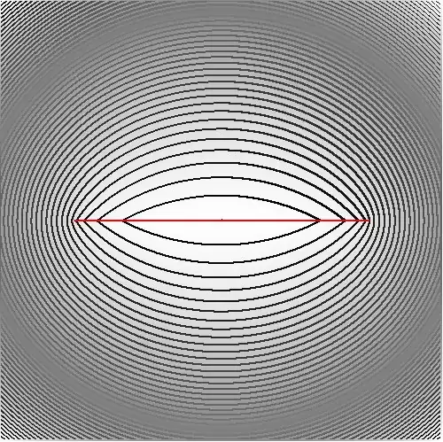

It has been established that we cannot calculate for being a subset, so the integral representing the arithmetic mean can safely be discarded. Then we are left with the Cauchy principal value of a Continuous Geometric Mean: $$ \operatorname{CGM}(\vec{r}) = \exp\left(-\!\!\!\!\!\!\int_0^1 \ln(\left|\vec{p}(t)-\vec{r}\right|^2)\,dt\right) $$ where for example $\,\vec{p}(t)\,$ is a curve in the plane and $\,\vec{r}\,$ is a point in the plane. For our straight line segment, we substitute: $$ \vec{p}(t) = (t,0) \quad ; \quad \vec{r} = (x,y) \\ \operatorname{CGM}(x,y) = \exp\left(-\!\!\!\!\!\!\int_0^1 \ln\left|(t-x)^2+y^2\right| dt \right) $$ A computer algebra system (MAPLE) has been employed for the purpose:
> int(ln((t-x)^2+y^2),t=0..1,continuous);
Giving that $\,\operatorname{CGM}(x,y) = e^{\Pi(x,y)}$ , with: $$ \Pi(x,y) = (1-x)\ln(1-2x+x^2+y^2)+x\ln(x^2+y^2)-2 \\ + 2y\left[\arctan\left(\frac{1-x}{y}\right)+\arctan\left(\frac{x}{y}\right)\right] $$ The result has been programmed and when visualized it looks as follows:
The lowest function values ($\approx 0.034$) are nearby the red line segment.
Window: xmin := -0.25; xmax := +1.25; ymin := -0.75; ymax := +0.75;
