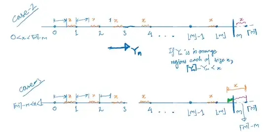

Adding a visualization of cases 2 and 3 from the first conditional equation of @ShubhamJohri's answer (for my own future reference; this helps see why the equation is true). Pasting the equation here:
$$\begin{align*}F_{Z_m}(x)&=P(\lceil Y_m\rceil-Y_m\le x)\\&=\begin{cases}0,&x\le0\\P(Y_m\in[k-x,k],k\in\Bbb N_{\le\lfloor m\rfloor}),&0<x\le \lceil m\rceil -m\\P(Y_m\in[k-x,k],k\in\Bbb N_{\le\lfloor m\rfloor})+P(\lceil m\rceil-x\le Y_m\le m),&\lceil m\rceil -m<x<1\\1,&x\ge1 \end{cases}\end{align*}$$
In case-2, we have to ignore the purple area. But in case-3, some of the purple area turns green and adds an additional term. The orange regions are common to both cases.
