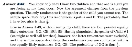

This is the solution to the second problem that I saw in the book:
I'm skeptical about the part of the solution where it says ". Having pinpointed the gender of Child #1 (we might as well call her that), however, the latter two outcomes are excluded." Getting rid of BG seems to rely on that you see the children in the order that they're listed, so if it's BG, it would have to be a boy that greets you at the door. But nothing in the problem suggests this, so I don't think this solution is accurate.
