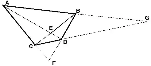

Let us consider, the 6 points of intersection $A, B, C, D, F, G$ of lines $L_i$ plus the intersection of diagonals $E$. This kind of figure is called a complete quadrangle that we will denote by $(Q)$.
This quadrangle has in particular an important property of harmonic division, but we will not use it here.
Let us do the same thing on the second set of line $M_i$, with points $A', B', C', D', E', F',G'$ (complete quadrangle (Q')).
As shown here there is a projective mapping $f$ mapping (Q) onto a square [which amounts to say, if we prefer a "static" point of view, that point $E$ has coordinates $(0,0)$, that vertices $A,B,C,D$ have coordinates $(\pm 1,\pm 1)$ and that points $G$ and $F$ are sent to infinity].
Let us call $f'$ the similar projective mapping senting (Q') onto a square.
Taking $\varphi := f'^{-1} \circ f$ gives the projective transformation mapping (Q) onto (Q'), therefore mapping all lines $L_i$ onto the corresponding lines $M_i$.
