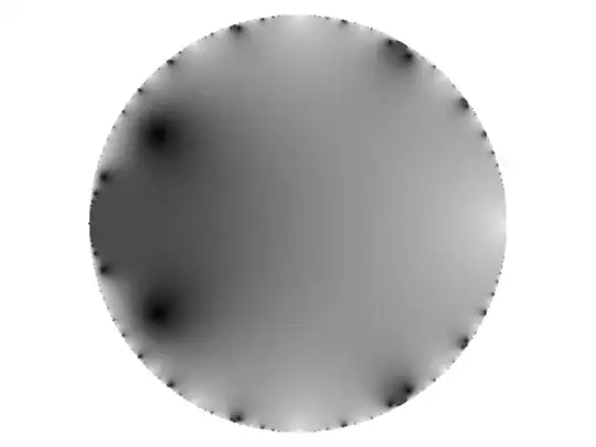

Let $\mathbb{D} = \{s \in \mathbb{C} : |s| < 1\}$. Let $f : \mathbb{D} \rightarrow \mathbb{C}$ where $$ f(s) = \sum_{n=0}^\infty s^{n^2} $$ $f$ is analytic on $\mathbb{D}$. This is what it looks like: enter image description here $\partial \mathbb{D}$ is a natural boundary, so ordinary analytic continuation cannot extend $f$ beyond $\mathbb{D}$. However, there might be another way to extend $f$ beyond $\mathbb{D}$ that is both aesthetically natural and yields a unique result. For example, see generalized analytic continuation and Continuation of functions beyond natural boundaries.

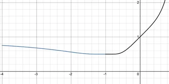

Further, one can show that the two functions, $$\sum_{n=0}^\infty x^{(n^2)} \text{ and } \sum_{n=0}^\infty x^{(-n^2)}$$ have derivatives that are all zero and agree at -1 by applying some regularizations to allow the functions to converge all the way up -1. The functions also just seem to mesh together in a natural way: enter image description here
I think this is only a first step, though, since the uniqueness problem is not addressed in any rigorous fashion--but I think they're some good reasons to think this is a good option for being the correct continuation. Let me know if you guys have any ideas on this.
