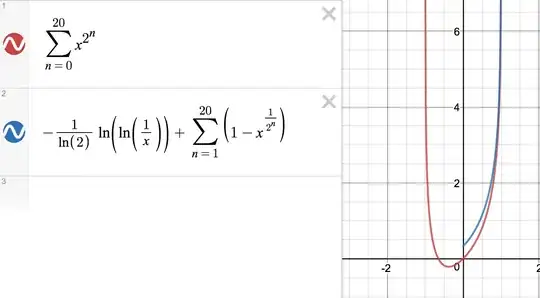

So you can graph $G(x) + \frac{i \pi}{\ln(2)} $, and observe it as a function, compared to the lacunary series above
Clearly the graphs are extremely similar. And it's not hard to see that $w(x) = g(x)-f(x)$ obeys the functional equation $w(x^2) = w(x)$.

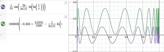

After taking the difference of the two graphs, it looks nearly constant but some careful inspection reveals that $w$ has non trivial structure and its first terms are
$$ \frac{i \pi}{\ln(2)} + w(x) \approx 0.333 + \frac{0.255}{1000} + c_0 \sin \frac{2\pi}{\ln 2} \ln \ln \frac{1}{x}... $$
Where $c_0 \approx 10^{-4}$ see below for visual evidence
