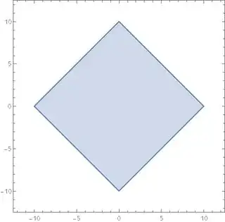

Basically we are given two normally distributed, independent random variables $X,Y \sim N(0,4)$ and want to find the distribution function of $|X|+|Y|$. I.e. for $a>0$ we want to calculate $$F_{|X|+|Y|}(a) = P(|X|+|Y|\leq a) $$ This means that we want to find the probability of $(X,Y)$ to lie within the set $$A = \{(x,y)\in\mathbb{R}^2 \mid |x|+|y|\leq a\} .$$ Geometrically $A$ is a square with corners at $(-a, 0)$, $(0, -a)$, $(a, 0)$ and $(0, a)$. For example, with $a=10$:
square

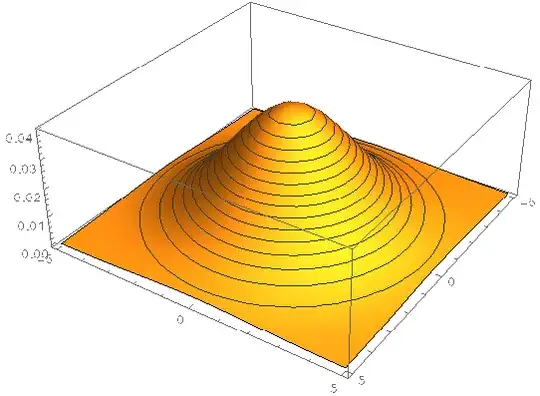

Now, because $X$ and $Y$ are independent, the random vector $(X,Y)$ is jointly normal-distributed with covariance matrix $\begin{pmatrix}4&0\\0&4\end{pmatrix}$. This means that it is rotationally invariant: for every angle $\alpha$, the rotated vector $$\begin{pmatrix} \cos \alpha& -\sin \alpha \\ \sin \alpha & \cos \alpha \\ \end{pmatrix}\begin{pmatrix}X\\Y\end{pmatrix}$$ has the same distribution as the vector $(X,Y)$ itself. (This can be checked using how a multivariate normal distribution changes under a linear transformation; note that the rotation matrix is orthogonal.) The symmetry can also be seen geometrically by plotting the density:
pdf

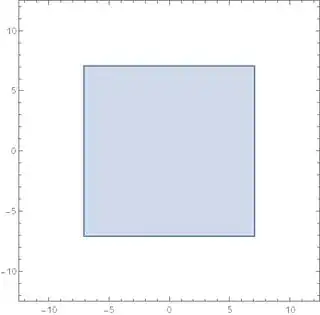

We can thus equivalently compute the probability of $(X,Y)$ lying in the rotated square $A'$. Now choose $\alpha=45^\circ$; rotating the square by $45^\circ$ yields a square with axis parallel sides (the side lengths remains the same: $\sqrt{2}a$)
square2
And now $$P((X,Y) \in A') = P\left(|X|\leq \frac{\sqrt{2}a}{2}, |Y|\leq \frac{\sqrt{2}a}{2}\right) = \left(F_{N(0,4)}\left(\frac{\sqrt{2}a}{2}\right) - F_{N(0,4)}\left(-\frac{\sqrt{2}a}{2}\right)\right)^2 .$$
