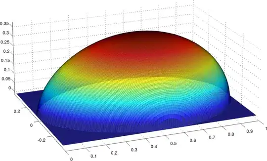

There is a nice equation describing the equation of an egg curve credit to Nobuo Yamamoto : $$ (x^2+y^2)^2 = ax^3 + \frac{3a}{10}xy^2, \tag{1} $$ where $0\leq x\leq a$, $a$ is the length of the major axis of symmetry for an egg.
In other words, we could get it by cutting a boiled egg in half and measure the distance from tip to the bottom. I just drew it in MATLAB, and the curve looks like the following for $a=1$: egg
I must say this curve fits pretty well with an egg. Now we have a curve, then the method of computing surface area by revolution, which is taught in Calculus II I believe, can be used to computing the surface. We just revolve the curve above around the egg's major axis of symmetry and get a surface, here is what looks like when we revolve it around the $x$-axis by degree $\pi$, we can get the lower half by revolve another $\pi$: eggsurf
First we solve for $y$ in (1) when $y>0$: $$ y = \sqrt{\frac{3ax}{20} - x^2 + x\sqrt{\frac{7ax}{10} + \frac{9a^2}{400}} }, $$ The formula of computing surface area by revolution is: $$ S = 2\pi\int_0^a y\sqrt{1+\left(\frac{dy}{dx}\right)^2} \,dx,\tag{2} $$ The derivative is: \begin{align} \frac{dy}{dx} = \frac{1}{2\sqrt{\frac{3ax}{20} - x^2 + x\sqrt{\frac{7ax}{10} + \frac{9a^2}{400}} }} \left( \frac{3a}{20}- 2x+ \sqrt{\frac{7ax}{10} + \frac{9a^2}{400}} + \frac{7ax}{20\sqrt{\frac{7ax}{10} + \frac{9a^2}{400}}}\right), \end{align} Plugging $dy/dx$ and $y$ into (2), then you could use your favorite tool of numerical integration to perform the computing for you(Octave, MATLAB, Mathematica, etc).

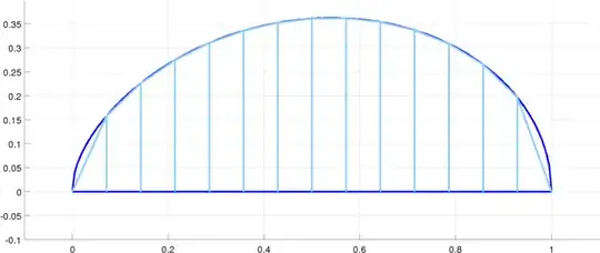

Now we want to compute the integral (2) using Simpson's rule or Trapezoidal rule, which is also taught in Calculus II in most colleges I believe. A remark is that $|f'|\to \infty$ when $x\to 0$ and $x\to a$, it would be much better if we use adaptive qudrature by putting more sample points near $0$ and $a$.
sample
The steps are:
  1. Boil an egg, cut it by half, hold it against a paper, use a pencil to outline its boundary (upper half is enough).
  2. Draw the major axis, set it to be the $x$-axis, and measure its length $a$.
  3. Choose $(n+1)$-sample points (including the end points) so that the points are equidistant to their neighbor on the curve. $n$ is chosen to be even, measure the distance to the major axis ($y$-coordinates) like the above figure.
  4. Denote the sample point as $(x_i,y_i)$, $x_0=0$, $x_n = a$.
  5. Approximate $$\frac{dy}{dx}\Big|_{x_i} \approx s_i = \frac{1}{2}\left( \frac{y_{i+1} - y_i}{x_{i+1} - x_i} + \frac{y_{i} - y_{i-1}}{x_{i} - x_{i-1}} \right).$$ For two end points: $$ s_0 = \frac{y_1 - y_0}{x_1 - x_0},\quad \text{ and }\quad s_n = \frac{y_n- y_{n-1}}{x_n - x_{n-1}}. $$ This step may be problematic, we can use other methods to approximate $dy/dx$: for example, approximating the curve by cubic spline using sample points $(x_i,y_i)$, but it would be beyond the content of college calculus.
  6. Let $h = x_{i+1} - x_i = a/n$, approximate (2) by computing: $$ \frac{2\pi h}{3}\bigg[g(x_0)+2\sum_{j=1}^{n/2-1}g(x_{2j})+ 4\sum_{j=1}^{n/2}g(x_{2j-1})+g(x_n) \bigg], \quad \text{ where } g(x_i) = y_i \sqrt{1+s_i^2}. $$

Amzoti gave a link in his comments above that has two semi-empirical formulas: $$ S_1 = (3.155 − 0.0136a + 0.0115b)ab, \;\text{ and }\;S_2 = \left(0.9658\frac{b}{a}+2.1378\right)ab $$ where $a$ and $b$ are the length for major and minor axis of the real eggs. If there exists an egg's shape like (1), $a = 1$, and $b\approx 0.7242629$, the surface area computed by above formula is: $$ S_1 \approx 2.278215 \;\text{ and }\;S_2 \approx 2.054946. $$ Using the surface by revolution formula (2), we have: $$ S \approx 2.042087. $$

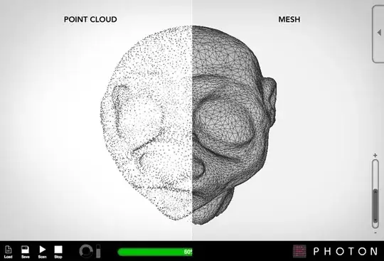

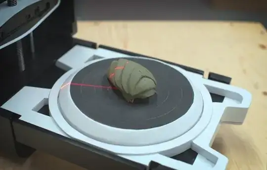

Get one of these things:
Load it up in your favorite 3D modelling software and let it calculate the surface area for you:
congusbongus
  • 611
  • 9
  • 13
    This is essentially an automated version of Zach L.'s answer. –  May 31 '13 at 06:25
  • Oh, so then I just measure the area of each triangle and then add them up, and I get the area from the measured string. – yiyi May 31 '13 at 06:33
