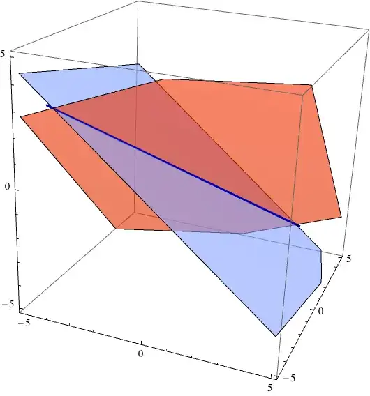

You can describe a line in space as the intersection of two planes. Thus, $$\{(x,y,z)\in{\mathbb R}^3: a_1x+b_1y+c_1z=d_1 \text{ and } a_2x+b_2y+c_2z=d_2\}.$$ Alternatively, you can use vector notation to describe it as $$\vec{p}(t) = \vec{p}_0 + \vec{d}t.$$
I used this relationship to generate this picture:
