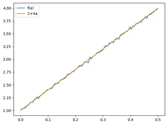

My ansatz was generated programmatically:
import numpy as np
def f(a): r = np.random.rand() if r < 2a: # Partial hit. return 1 + f(np.random.rand() a) if r - 2*a < 0.5 - a: # Complete miss. return 1 + f(a)
# Complete hit.
return 1
def favg(a, it=10000): return sum(f(a) for _ in range(it))/it
A = np.linspace(0.0001, 0.5, 100) fa = np.array([favg(a) for a in A]) plt.plot(A, fa, label="f(a)") plt.plot(A, 2+4*A, label="2+4a") plt.legend() plt.tight_layout() plt.show()
graph
