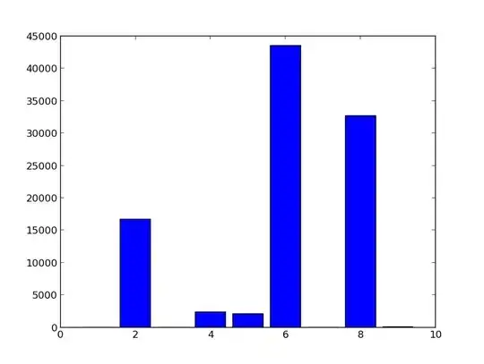

A digit product $P(n)$ of a natural number $n$ is given by the product of its decimal digits. For example:
$$P(1234) = 24,\;\;\; P(24) = 8,\;\;\; P(8) = 8$$ $$1\times2\times3\times4 = 24, \;\;\; 2\times4 = 8$$
Clearly $P(x) \leq x$ as a number with digits "abcd..." gives a product less than $a\times10\times10\times10...$. So
$$P(x) < x\;\;\; \text{or}\;\;\; P(x) < 10$$
Letting $P^n(x)$ represent applying $P$ $n$ times, I have a question about $$P^\infty(x) = \lim_{n\rightarrow\infty}P^n(x)$$
The larger the number the more likely it is that it will contain a zero. So, for a random $x$ we expect that almost always $P^\infty(x)=0$. But we can get rid of all these from the number line:
$$S = \{x\in\mathbb{N}_0|P^\infty(x)\neq0\}$$
What is the distribution of $P^\infty(s)$ for $s\in S$? How likely are the remaining digits? Is one infinitely more likely than the others?
Here's a graph of $10$ to $1,000,000$: WTF!!!

So even though up to 50 million the histogram shows a pattern similar to yours: $$ \begin{array}{c|c|c|c|c|c|c|c|c|c} P^\infty & 1 & 2 & 3 & 4 & 5 & 6 & 7 & 8 & 9 \\ \hline \mathrm{count} & 8 & 317446 & 36 & 27070 & 16325 & 1336881 & 35 & 697581 & 119 \end{array} $$ my results suggest that eventually $P^\infty=4$ will dominate $P^\infty=2$, and in the large $N$ limit almost all of $S$ will be made up of numbers with thirty-nine 2s, three 3s, two 7s and a large number of 1s, each with $P^\infty=8$.
