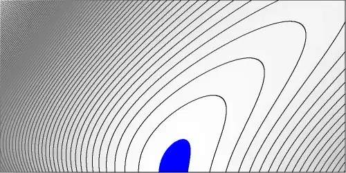

To get a first impression, we start with a pictorial exercise: contouring of the function. After some attempts, it seems that the following window may be interesting:
  xmin := 0; xmax := 2;
  ymin := 1; ymax := 2;
Maximum and minimum vales of $f(x,y)$ are determined first and the place of the minimum is estimated numerically:
 1.39061000309967E-0007 < f < 4.38447187191170E-0001
f( 1.00100100100100E+0000, 1.00200803212851E+0000) =  1.39061000309967E-0007
There are $75$ (vertically) equidistant isolines between the minimum and the maximum. The picture is colored blue for funcion values $f(x,y) < 0.001$. It is suggested - not formally proved - that maybe a global minimum equal to zero is found for $x$ and $y$ equal to one: $f(1,1)=0$. Let's check this. A computer algerba system (MAPLE) has been employed when calculations became tedious (and essentially uninteresting as well):
