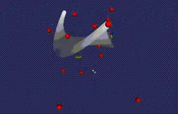

Sim of My Attempt $$ \text{This ^ uses Eq.1 with:}\ \ \ \ \hat{\tau} = \cos(\theta)\frac{\frac{\partial r}{\partial x}}{\big{|}\big{|}\frac{\partial r}{\partial x}\big{|}\big{|}} + \sin(\theta)\frac{\frac{\partial r}{\partial y}}{\big{|}\big{|}\frac{\partial r}{\partial y}\big{|}\big{|}} ,\ \ \ \ \dot{\theta}=\omega$$ The error is that for $\omega = 0$ and $v \neq 0$, holding $\hat{\tau}$ some fixed $\theta$ away from a gradient direction doesn't cause the ant to move along a geodesic. Moreover, it doesn't make sense for $\theta=0$ to yield a $\frac{\partial r}{\partial x}$-follower... $\hat{\tau}$ really needs to be parallel-transported along the surface. Parallel-transport is a statement about how tangent vectors (e.g. $\dot{r}$) change, so we need to examine acceleration.
