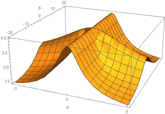

For point $4)$, what numerical simulation did you use? I tried to simulate that specific polynomial, $p(x)=(x^2+a^2)(x-b)^2$, for $d=4$ and I gotGraph for the polynomial
for $I(p)$. Indeed for $a=0$, $p(x)$ has all real roots so by your point $1)$ the center line in the above graph is exactly $4$. Since it appears that everything is increasing towards this line, it would appear that the maximum of $I(p)$ is $4$ for this case.

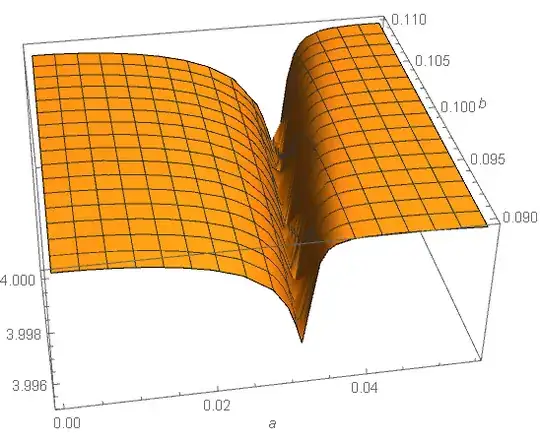

After getting the points $a=\frac{1}{\sqrt{500}}$ and $b=\frac{1}{10}$ I can recreate the same plot above but zoomed in:
Strange behavior
The right side of this graph is just ever so slightly greater than $4$. However, this graph just raises more questions than answers in my mind: what is that valley, why is it so steep and sudden, etc.?

  • I utilized Mathematica 11. For example, you can check that $$p(x)=(x-\tfrac{1}{10})^2(x^2+\tfrac{1}{500})\qquad\Rightarrow\qquad I(p)=4.0001885717300436549\cdots.$$ I am quite certain that this is not an artifact of numerical computation. – Sangchul Lee Jul 02 '21 at 15:39
  • Thank you, with those numbers I was able to zoom in and see... something? I really have no idea what the graph shows at this point. – QC_QAOA Jul 02 '21 at 16:17
