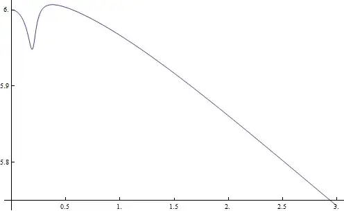

Counterexample 2. On the other hand, we find that for $$p(t) = (t-1)^4 (t^2 + 1/9),$$ a numerical calculation by Mathematica 8.0 shows that $$ \frac{1}{\pi} I(i/3, -i/3, 1, 1, 1, 1) \approx 6.0058731199379896917, $$ which exceeds $6$. Indeed, the graph of $u \mapsto \pi^{-1} I(iu, -iu, 1, 1, 1, 1)$ is given by
