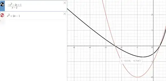

So I just waneted to ask - am I missing something? Is it possible to make here $x_{1+n} - x_{n} = \frac{-x_{n}^2-2x_n+1}{2 + x_{n}}$ an equality with $0$ and analyse simpler function (red one on the picture)?

  • Ok. I'm happy that you understand my struggle. I wasn't sure if I expressed myself clear enough with my problem. But you confirm that there is no way to build an equality with $0$ in that place (it would be a different function, so I can't just analyse what is 'easier to analyse'), right? – theboyboy Nov 24 '20 at 06:13
    I don't understand what you mean by build an equality with $0$ in some place. I am subtracting off the limit from a term, so you could look at this as a new series of the $\epsilon_i$, which will converge to $0$. There are other ways to show convergence than a bounded monotone sequence. Sequences that bounce above and below the limit but keep getting closer converge as well. An approach like mine will work with those. The multiplier on $\epsilon$ comes out negative, but greater than $-1$ so the distance from the limit is always reduced. – Ross Millikan Nov 24 '20 at 06:17
  • I was not referring directly to your answer, but to my question, to get a definitive answer. Just wanted to confirm that there is no way to make here $x_{1+n} - x_{n} = \frac{-x_{n}^2-2x_n+1}{2 + x_{n}}$ an equality with $0$ and analyse simpler function. If there is no way, then I will use your method for sure. – theboyboy Nov 24 '20 at 06:23
