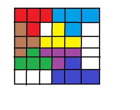

The figure of polyomino
I just drew the figure and manually tried the question but I am wondering is there a way to do this problem via permutations and combinations.
PS: I got answer as 7.

I filled the 6x6 square manually withou any calculation or considering possibility of other cases.
