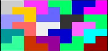

Here's an example I found by hand:
  • Thanks. I was already almost 100% sure that the answer would be negative. :) It – Ievgen Dec 18 '15 at 13:30
  • It probably can be interesting to describe n and k for which nx(3k) rectangle can be tiled by L-blocks. (Obviously the answer is positive for 1) rectangles nx(9l), where n is odd and greater than 5 (based on the given example); 2) rectangles nx(3k), where n is even.) – Ievgen Dec 18 '15 at 13:48

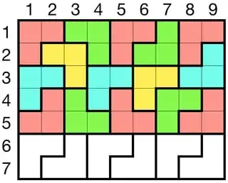

As shown below (in color) a $9 \times 5$ rectangle can be tiled with L trominoes.
This can be extended (in white) to tile a $9 \times 7$ rectangle.
Tiling with L trominoes
