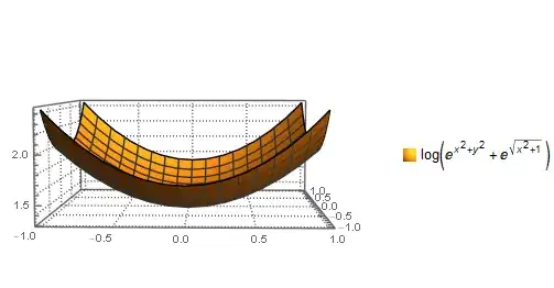

We can use Mathematica with the instruction
  • Plot3D[Log[E^(x^2+y^2)+E^Sqrt[x^2+1]],{x,-1,1},{y,-1,1},PlotTheme->"Detailed"]
Then we get the following picture enter image description here
and this is not an answer because Martin R give a nice answer but I think it helps to see intuitively why the result about the convexity of $\displaystyle (x,y)\mapsto \log\left(e^{x^{2}+y^{2}}+e^{\sqrt{x^{2}+1}}\right)$ holds over $e^{x^{2}+y^{2}}+e^{\sqrt{x^{2}+1}}>0$ so over $e^{x^{2}+y^{2}}>-e^{\sqrt{x^{2}+1}}>0$ so over all $\mathbb{R}^{2}$.
