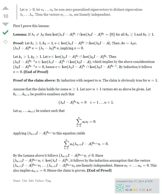

I have doubts for the second part of this proof by @daw, would you help explain?
  1. Does $A$ have fixed sets of eigenvalues? If so, why can this proof add additional $\lambda_i$ arbitrarily?
  2. Why $(\lambda_{n+1}I - A)^{k_{n+1}}\cdot v_{i} \in ker(\lambda_{i}I - A)^{k_{i}})$ ?
  3. For the last step, from what we infer $a_{n+1} = 0$ ? Since $(\lambda_{n+1}I - A)^{k_{n+1}}\cdot v_{n+1} = 0$, $a_{n+1}$ is not necessarily zero.
Attached Snapshot
Update: proof for question $2$. Assume $\lambda \neq \lambda_i$ and define $$X=(\lambda I - A)^{k}, $$$$W=(\lambda_{i}I - A)^{k_{i}}$$$k_{i}$ is the smallest integer that satisfy $Wv_{i}=0$ by definition. Since $$XW=WX$$hence $$WXv_{i} = XWv_{i} = 0$$
which means $Xv_{i}\in ker(W)$.
Kuo
  • 157
  1. The induction only works for $\ n\ $ up to and including the number of distinct eigenvalues of $\ A\ ,$ but if $\ n\ $ is less than that number then you can clearly$\left.\right.^\color{red}{\dagger}$ carry out the induction step to prove the claim for $\ v_1,v_2,\dots,v_{n+1}\ .$
  2. I see you've already answered question $2$ yourself. Here's an alternative, slightly simpler, argument. Since $\ \big(\lambda_iI-A\big)\big(\lambda_{n+1}I-A\big)=\big(\lambda_{n+1}I-A\big)\big(\lambda_iI-A\big)\ $ then \begin{align}\big(\lambda_iI-A\big)^{k_i}\big(\lambda_{n+1}I-A\big)^{k_{n+1}}v_i&=\big(\lambda_{n+1}I-A\big)^{k_{n+1}}\big(\lambda_iI-A\big)^{k_i}v_i\\&=0\ .\end{align} Therefore, by definition, $\ \big(\lambda_{n+1}I-A\big)^{k_{n+1}}v_i\in\ker\big(\big(\lambda_iI-A\big)^{k_i}\big)\ .$
  3. There was a typo$\left.\right.^\color{red}{\dagger\dagger}$ in the equation in the sentence "Let $\ a_1,$$\,a_2,$$\,\dots,$$\,a_{n+1}\ $ be scalars such that $$\sum_{i=1}^{\color{red}{n+1}}a_iv_i=0\ "\tag{1}\label{e1}$$ When you multiply this equation by $\ \big(\lambda_{n+1}I-A\big)^{k_{n+1}}\ ,$ the final term of the sum vanishes, still leaving you with the equation $$\sum_{i=1}^na_i\big(\lambda_{n+1}I-A\big)^{k_{n+1}}v_i=0 $$ from which the proof proceeds as given. Once you've concluded that $\ a_1=a_2=\dots=a_n=0\ ,$ then $\ a_{n+1}=0\ $ follows from equation $(\ref{e1})$, because $\ v_{n+1}\ne0\ .$

On reflection, it seems to me that the appeal to induction makes unnecessarily heavy weather of the proof. If $$ \sum_{i=1}^na_iv_i=0\ ,\tag{2}\label{e2} $$ and $\ k_1,k_2,\dots,k_n\ $ are positive integers such that $\ \big(\lambda_iI-A\big)^{k_i}v_i=$$\,0\ $ for all $\ i\ $, then multiplying equation (\ref{e2}) by $\ \prod_\limits{\ell=1\\\ell\ne j}^n\big(\lambda_\ell I-A\big)^{k_\ell}\ $ gives \begin{align} 0&=\sum_{i=1}^na_i\prod_\limits{\ell=1\\\ell\ne j}^n\big(\lambda_\ell I-A\big)^{k_\ell}v_i\\ &=\sum_{i=1\\i\ne j}^na_i\left(\prod_\limits{\ell=1\\\ell\ne j\\\ell\ne i}^n\big(\lambda_\ell I-A\big)^{k_\ell}\right)\big(\lambda_i-A\big)^{k_i}v_i\\ &\hspace{1em}+a_j\prod_\limits{\ell=1\\\ell\ne j}^n\big(\lambda_\ell I-A\big)^{k_\ell}v_j\\ &=a_j\prod_\limits{\ell=1\\\ell\ne j}^n\big(\lambda_\ell I-A\big)^{k_\ell}v_j\ .\tag3\label{e3} \end{align} Since $\ v_j\ $ is a generalised eigenvector of $\ A\ $ corresponding to the eigenvalue $\ \lambda_j\ ,$ there exists a non-negative integer $\ t\ $ such that $\ \big(\lambda_j I-A)^tv_j\ $ is an eigenvector corresponding to the same eigenvalue. Multiplying both sides of equation (\ref{e3}) by $\ \big(\lambda_j I-A)^t\ $ therefore gives \begin{align} 0&=a_j\big(\lambda_j I-A)^t\prod_\limits{\ell=1\\\ell\ne j}^n\big(\lambda_\ell I-A\big)^{k_\ell}v_j\\ &=a_j\left(\prod_\limits{\ell=1\\\ell\ne j}^n\big(\lambda_\ell I-A\big)^{k_\ell}\right)\big(\lambda_j I-A)^tv_j\\ &=a_j\left(\prod_\limits{\ell=1\\\ell\ne j}^n\big(\lambda_\ell-\lambda_j\big)^{k_\ell}\right)\big(\lambda_jI-A)^tv_j \end{align} from which it folllows that $ \ a_j=0\ ,$ because $\ \lambda_j\ne\lambda_\ell \ $ for any $\ \ell\ne j\ ,$ and $\ \big(\lambda_jI-A)^tv_j\ne0\ $ is an eigenvector corresponding to the eigenvalue $\ \lambda_j\ .$

  • Life is so hard... it would be nice if elaborate more on substituting $A$ with $\lambda_i$ – Kuo Jan 21 '24 at 20:33
  • I've now added an updated version of the proof, which turned out not to be quite as cumbersome as I had initially thought. – lonza leggiera Jan 23 '24 at 10:09
  • I just realize both proofs are based on a assumption of n distinct eigenvalues... So that we can confidently conclude the proof at equation (3), if $\ell \neq j$, the product $\prod * v_j$ can not be 0. For $v_j \in ker(\lambda_j I - A)^{k_j}$ by definition, a generalized EigenVector can not be in both EigenSpaces. The following step to multiply $(\lambda_j I - A)^t$ should not change the scenario. I believe the only condition can we replace $A$ with $\lambda_j$ is $t \geq k_j$ – Kuo Jan 24 '24 at 17:55
  • I don't understand the final sentence of this comment. For any given $\ j\ $ the number $\ t\ $ is uniquely defined by the requirement that $\ \big(\lambda_jI-A)^tv_j\ $ be an eigenvector of $\ A\ $ and must satisfy $\ 0\le t\color{red}{<}k_j\ $ because $\ (\lambda_j-A)^uv_j=0\ $ for all $\ u\ge k_j\ .$ And since $\ (\lambda_jI-A)^tv_j\ $ is an eigenvector corresponding to eigenvalue $\ \lambda_j\ $ then $\ p(A)(\lambda_jI-A)^tv_j=$$,p(\lambda_j)(\lambda_jI-A)^tv_j\ $ for any polynomial $\ p\ .$ – lonza leggiera Jan 24 '24 at 23:25
  • Now I see. I'm swaying back and forth the narrative of distinctive eigenvalues of the original question and the real life. Following equations (3), it assumes there exist repeated eigenvalues, while in the first place, to multiply $\prod\limits_{\substack{\ell = 1 \ \ell \neq j}}^n({\ell}−)^{{\ell}}$ will get us trouble. It can be vanished because of this repetitiveness. For not crowding the comment area, I had explained the confusion in another thread. But I still prefer your answer and preserve the vote. – Kuo Jan 25 '24 at 05:19
