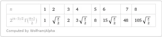

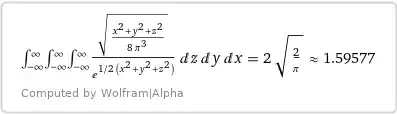

Since $$A(n)=\int\limits_0^\infty r^n e^{-\frac12r^2}\text dr = 2^{^{\large\frac{n-1}2}}\Gamma\left(\dfrac{n+1}2\right),\tag7$$
Table I_1(n)

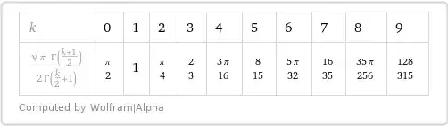

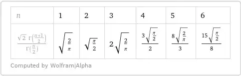

$$\Phi_2(k) = \int\limits_0^{^{\large \frac\pi2}}\,\sin^k\varphi\,\text d\varphi =\dfrac{\sqrt\pi\, \Gamma\left(\dfrac{k+1}2\right)}{2 \Gamma\left(\dfrac{k+2}2\right)},\tag8$$
Table I_2(k)
then $$M_n = \left(\dfrac2\pi\right)^{^{\large\frac n2}}A(n)\prod\limits_{k=1}^{n-1}\Phi_2(k-1) = \sqrt2\,\dfrac{\Gamma\left(\dfrac{n+1}2\right)}{\Gamma\left(\dfrac n2\right)}.\tag9$$
The table of In
Checking n=2
Checking n=3

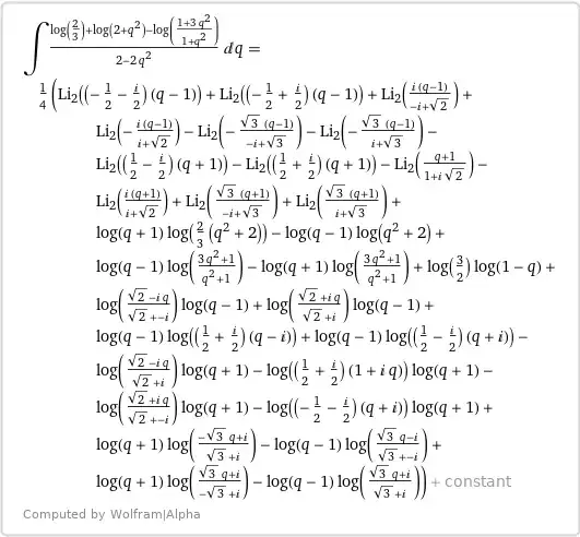

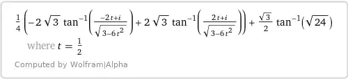

$\color{brown}{\mathbf{The\ second\ integral,\ n=5.}}$

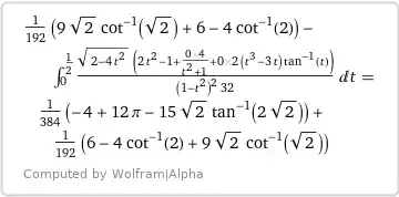

Taking in account $(13a-c),$ one can get $$\Phi_\infty(5) = \int\limits_{\large^\pi/_4}^{\large^\pi/_2} \int\limits_{\text{arccot }c_1}^{\large^\pi/_2}\; \int\limits_{\text{arccot }c_2}^{\large^\pi/_2}\; \int\limits_{\text{arccot }c_3}^{\large^\pi/_2} \sin\varphi_1\sin^2\varphi_2\sin^3\varphi_3\sin^4\varphi_4 \,\text d\varphi_4\,\text d\varphi_3\,\text d\varphi_2\,\text d\varphi_1 \\[4pt] = \int\limits_{\arctan\sqrt2}^{\large^\pi/_2} \int\limits_{\large^\pi/_4}^{\arccos\cot\varphi_2} \int\limits_{\text{arccot }c_2}^{\large^\pi/_2}\quad \int\limits_{\text{arccot }c_3}^{\large^\pi/_2} \sin\varphi_1\sin^2\varphi_2\sin^3\varphi_3\sin^4\varphi_4 \,\text d\varphi_4\,\text d\varphi_3\,\text d\varphi_1\,\text d\varphi_2 \\[4pt] = \int\limits_{\arctan\sqrt2}^{\large^\pi/_2}\quad \int\limits_{\text{arccot }c_2}^{\large^\pi/_2}\; \left(\dfrac1{\sqrt2}-\cot\varphi_2\right) \dfrac1{16}\left(\sin2\varphi_4\cos2\varphi_4 - 4\sin2\varphi_4 + 6\varphi_4\right)\bigg|_{\text{arccot }c_3}^{\large^\pi/_2}\\ \times\sin^2\varphi_2\sin^3\varphi_3 \,\text d\varphi_3\,\text d\varphi_2\\[4pt] = \int\limits_{\arctan\sqrt2}^{\large^\pi/_2}\quad \int\limits_{\text{arccot }c_2}^{\large^\pi/_2}\; \dfrac{\sqrt2\,\sin^2\varphi_2-\sin2\varphi_2}{16}\\ \times\left(3\arctan\cos\varphi_3+\dfrac{4\cos\varphi_3}{1+\cos^2\varphi_3} +\dfrac{3\cos\varphi_3\sin^2\varphi_3}{(1+\cos^2\varphi_3)^2}\right) \sin^3\varphi_3\,\text d\varphi_3\,\text d\varphi_2\\[4pt] = \int\limits_{\large^\pi/_3}^{\large^\pi/_2}\quad \int\limits_{\arctan\sqrt2}^{\arccos\cot\varphi_3}\; \dfrac{\sqrt2\,\sin^2\varphi_2-\sin2\varphi_2}{16}\\ \times\left(3\arctan\cos\varphi_3+\dfrac{3\cos\varphi_3}{1+\cos^2\varphi_3} +\dfrac{2\cos\varphi_3}{(1+\cos^2\varphi_3)^2}\right) \sin^3\varphi_3\,\text d\varphi_2\,\text d\varphi_3\\[4pt] = \dfrac{\sqrt2}{64}\int\limits_{\large^\pi/_3}^{\large^\pi/_2}\quad \left(2\varphi_2 - \sin 2\varphi_2 + \sqrt2 \cos 2\varphi_2\right) \bigg|_{\arctan\sqrt2}^{\arccos\cot\varphi_3}\; \times\left(3\arctan\cos\varphi_3+\dfrac{3\cos\varphi_3}{1+\cos^2\varphi_3} +\dfrac{2\cos\varphi_3}{(1+\cos^2\varphi_3)^2}\right) \sin^3\varphi_3\,\text d\varphi_3\\[4pt] = \dfrac{\sqrt2}{32}\int\limits_{\large^\pi/_3}^{\large^\pi/_2}\quad \left(\sqrt2\cot^2\varphi_3 - \cot\varphi_3 \sqrt{1-\cot^2\varphi_3} + \arccos \cot\varphi_3 -\arctan\sqrt2\right) \times\left(3\arctan\cos\varphi_3+\dfrac{3\cos\varphi_3}{1+\cos^2\varphi_3} +\dfrac{2\cos\varphi_3}{(1+\cos^2\varphi_3)^2}\right) \sin^3\varphi_3\,\text d\varphi_3\\[4pt] = \dfrac{\sqrt2}{64}\int\limits_{\large^\pi/_3}^{\large^\pi/_2}\quad \left(\sqrt2\cot^2\varphi_3 - \cot\varphi_3 \sqrt{1-\cot^2\varphi_3} + \arccos \cot\varphi_3 -\arctan\sqrt2\right) \times\,\text d\left(\cos 2\varphi_3 + 2(\cos^3\varphi_3-3\cos\varphi_3)\arctan\cos\varphi_3+\dfrac{4}{1+\cos^2\varphi_3}\right)$$
(see also WA check),

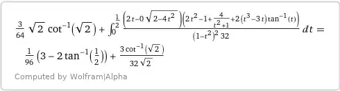

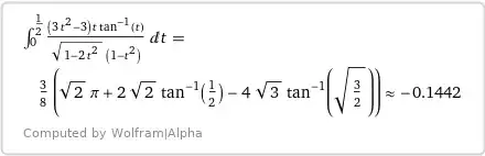

$$\Phi_\infty(5) \;\overset{\text{IBP}}{=\!=} \; \dfrac{3\sqrt2 \text{ arccot}\sqrt2}{64} + \dfrac{\sqrt2}{32} \int\limits_{\large^\pi/_3}^{\large^\pi/_2}\quad \left(\sqrt2\cot\varphi_3 - \sqrt{1-\cot^2\varphi_3}\right) \times \left(2\cos^2\varphi_3 -1 + 2(\cos^3\varphi_3-3\cos\varphi_3) \arctan\cos\varphi_3+\dfrac{4}{1+\cos^2\varphi_3}\right)\dfrac{\text d\varphi_3}{\sin^2\varphi_3}\\[4pt] = \dfrac{3\sqrt2 \text{ arccot}\sqrt2}{64} + \dfrac{\sqrt2}{32} \int\limits_0^{\large^1/_2}\quad \left(\sqrt2c_3 - \sqrt{1-2c^2_3}\right)\\ \times \left(2c^2_3 -1 + 2(c^3_3-3c_3) \arctan c_3+\dfrac{4}{1+c^2_3}\right)\dfrac{\text dc_3}{(1-c^2_3)^2}\\[4pt] = \dfrac{12\pi + 18\sqrt2 \text{ arccot}\sqrt2 - 8\text{ arccot }2 - 15\sqrt2 \arctan(2\sqrt2) -12\sqrt6 \arctan\sqrt{^3/_2}}{384}\\ - \dfrac{\sqrt2}{16} \int\limits_0^{\large^1/_2}\quad \sqrt{1-2c^2_3}(c^3_3-3c_3) \arctan c_3 \dfrac{\text dc_3}{(1-c^2_3)^2}, $$ Phi(5) term1 Phi(5) term21 Phi(5) term22

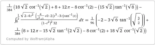

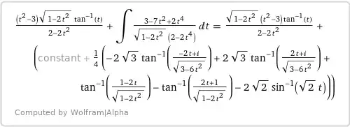

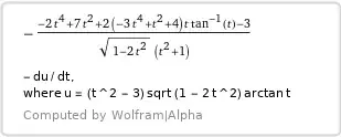

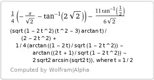

wherein $$\int\limits_0^{\large^1/_2}\quad \sqrt{1-2t^2}(t^3_3-3t) \arctan t \dfrac{\text dt}{(1-t^2)^2}\\[4pt] \;\overset{\text{IBP}}{=\!=} -\dfrac{11\sqrt2\text{ arccot }2}{12} + \dfrac18 ((4\sqrt3-\sqrt2)\pi - 2\arctan(2\sqrt2) - 4\sqrt3\arctan(2\sqrt6)) + \int\limits_0^{\large^1/_2} \dfrac{t(3 t^2-4)\arctan t}{\sqrt{1 - 2 t^2}(1-t^2)}\,\text dt =-\dfrac{11\sqrt2\text{ arccot }2}{12} + \dfrac14 ((2\sqrt3+\sqrt2)\pi - \arctan(2\sqrt2) - 2\sqrt3\arctan(2\sqrt6)) + \dfrac34 (\sqrt2 \text{ arccot }2 - 2\sqrt3 \arctan\sqrt{\dfrac32} - \int \limits_0^{\large^1/_2} \dfrac{t \arctan t}{\sqrt{1 - 2 t^2}(1-t^2)}\,\text dt ,$$
IBP derivative IBP partial integration IBP first part
IBP second part = IBP second part result

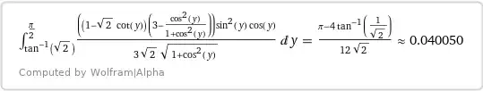

$$- \int\limits_0^{\large^1/_2} \dfrac{t \arctan t}{\sqrt{1 - 2 t^2}(1-t^2)}\,\text dt = \int\limits_{\large^1/_{\sqrt2}}^1 \dfrac{\arctan\sqrt{\dfrac{1-u^2}2}} {1+u^2}\,\text du = \int\limits_{\large^1/_{\sqrt2}}^1 \int\limits_{0}^{\large\sqrt{\frac{1-u^2}2}} \dfrac{\text dv\,\text du}{(1+v^2)(1+u^2)}\\[4pt] = \int\limits_0^{\text{arccot}\sqrt2} \int\limits_{{\large^1/_{\sqrt2}}\sec\psi}^{\large^1/_{\sqrt{\cos^2\psi + 2\sin^2\psi}}} \dfrac{\rho\,\text d\rho\,\text d\psi}{(1+\rho^2\cos^2\psi)(1+\rho^2\sin^2\psi)}\\[4pt] =\left|\genfrac{}{}{0}{}{s=\rho^{-2},}{w = 2\psi}\right| = \int\limits_0^{2\text{ arccot}\sqrt2} \int\limits_{\frac12(3-\cos w)}^{1+\cos w} \dfrac{\text ds\,\text dw}{(1+2s)^2-\cos^2w}\\[4pt] = \dfrac14\int\limits_0^{2\text{ arccot}\sqrt2} (\ln4 - \ln(4-2\cos w) + \ln(3+\cos w)-\ln(3+3\cos w)) \dfrac{\text dw}{\cos w}\\[4pt] = \dfrac14\int\limits_0^{2\text{ arccot}\sqrt2} (- \ln(1-\frac12\cos w) + \ln(1+\frac13\cos w)-\ln(1+\cos w)) \dfrac{\text dw}{\cos w}\\[4pt] =|w=2\arctan q| =\int\limits_0^{\large^1/_{\sqrt2}} (\ln(1+q^2)+\ln(2+q^2)+\ln 2-\ln(3+q^2)-\ln 3)\dfrac{dq}{2-2q^2}\\[4pt] =J\left(\dfrac1{\sqrt2}\right)- J(0)\approx 0.05721\,19956\,66783\,53930\,89922\,14090\,04283\,86906\,04 ,$$ wherein splitting both of the numerator and the denominator leads to the heavy closed form of the antiderivative $\;J(q),$
Closed form J(q)
