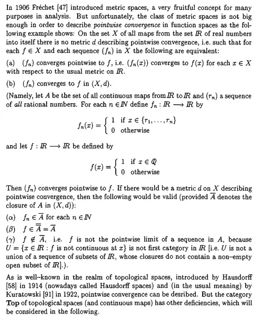

We need the general notion of metric spaces in order to cover convergence in $\mathbb{R}^n$ and other spaces. But why do we need topological spaces? What is it we cannot do in metric spaces?
I have read the answers at Motivation of generalizing the theory of metric spaces to the theory of topological spaces and want to emphasize this example I found in Preuss "Foundations of Topology":
Enter image description here
Sorry for the big image, but I want to be sure you know what I mean. So does this mean we cannot describe pointwise convergence in a metric space? Can you elaborate more on this specific example? I don't really see the conclusion.
Another point is that Preuss explains that continuous convergence cannot be described in topological spaces (I am not sure if he is referring just to Hausdorff-spaces here).

The point Preuss makes is that we cannot find a metric $d$ on the set of function such that "$f_n \to f$ pointwise" is equivalent to "$f_n \to f$ in the metric $d$" or $d(f_n,f) \to 0$ etc. Uniform convergence does correspond to a metric (from the supremum-norm). But we can define something more general, a topology, such that we can define $f_n \to f$ in that topology , and moreover in such a way that it exactly corresponds with "$f_n \to f$ pointwise".

  • Thank you for the clarification, but I don't understand his proof that there is no metric which describes pointwise convergence. Why is $f_n\in \overline{A}$ and not just in $A$ and why is $f\notin \overline{A}$? And further what characteristic has this topology where this is defined? – Averroes2 Oct 06 '20 at 17:23
  • @Averroes2 Preuss uses that if a topology comes from a metric, the closure of a set is the set of sequence limits from that set. In this case though he shows that is not the case as the sequence limits can form a new sequence with a new limit that is not a limit from the original set. So sequential closure is not equal to closure and under a metric that would have been the case. – Henno Brandsma Oct 06 '20 at 17:35
