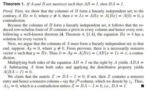

If $A$ and $B$ are square matrices such that $AB = I$, where $I$ is the identity matrix, show that $BA = I$.
I do not understand anything more than the following.
  1. Elementary row operations.
  2. Linear dependence.
  3. Row reduced forms and their relations with the original matrix.
If the entries of the matrix are not from a mathematical structure which supports commutativity, what can we say about this problem?
P.S.: Please avoid using the transpose and/or inverse of a matrix.

The following proof appears in the article A Short and Elementary Proof of the Two-sidedness of the Matrix-Inverse [Paparella, P., College Math. J. 48 (2017), no. 5, 366-367; MR3723713] and only uses the criteria stipulated by the OP:
Pietro Paparella
