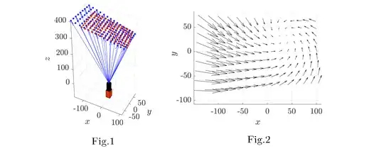

I have $2$ sets of $3D-\text{Pointclouds}$ $P_1$ and $P_2$ (shown in Red and Blue respectively) that lie on a common plane $(\text{Fig.} 1).$ The orientation of the plane (with respect to origin) is known and is defined by a transformation matrix (Rotation and Translation) say $\mathbf{T}_0 = [\mathbf{R}_0| \mathbf{t}_0]$. Using the local coordinates of the points on the plane and $\mathbf{T}_0$, I can compute the global coordinates of each point in the pointcloud with respect to origin.
By connecting the elements from $P_2$ with its corresponding element in $P_1$ I obtain a vector field $\mathbf{V}$ which when projected in the $xy-$Plane appears as illustrated in the $\text{Fig.2}.$

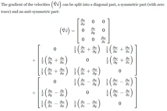

Since I don't know the scalar function that describes the vectorfield but only the coordinates of each vector in the $xy$-plane, how can one split $\mathbf{V}$ into $3$ matrices: a diagonal matrix, a symmetric matrix (with zero trace) and an anti-symmetric matrix as stated in this answer, which says
