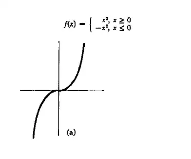

I'm trying to understand what is meant by "reparameterizing hides a corner". What does the author mean by "hide" in what sense is it being hidden? For reference, the function that this is being applied to is the following:
$$ f(x) = \left\{ \begin{array}\ x^{2},\ x \geq 0 \\ -x^{2},\ x \leq 0 \\ \end{array} \right.$$
EDIT: Image of fig 21 as requested

@IsaacBrown 's answer is concise and correct. Here's another way to understand what is going on.
If you think about physically tracing the graph of $|x|$ between $(-1,1)$ and $(1,1)$ as you move at unit speed along the $x$-axis then the corner at the origin requires an instantaneous change of direction.
If you slow down so that your speed approaches $0$ as you approach the origin then there's no sudden change of direction there, and you speed up afterwards. That's how the given reparameterization "hides the corner".

The corner here is the point $(0,0)$, as it is a non-differentiable corner of the curve represented by the graph of $h(x)=|x|$ (parametrized by $(t,h(t))$).
This non-differentiability is what is being hidden by this reparametrization of the curve as both $f(t)$ and $t^2$ are differentiable functions. The way it does this is by having derivative $0$ for both the $f(t)$ and $t^2$ at $(0,0)$.

  • But the graph of h(x) only appears after we take the derivative of the original function. So what you're saying is that if I "wanted" to take the derivative of my derivative (i.e $c''(t)$) it is here where trouble will come about ? – D.C. the III Aug 15 '20 at 22:58
    The point is not that $h(x)$ is the derivative of the parametrization. That is merely a coincidence. The point is that $(t,h(t))$ and $(f(t),t^2)$ represent the same line. I'll clarify this – Isaac Browne Aug 15 '20 at 23:06
  • Ah!!!....OK I see what you mean now. Thanks for your help. – D.C. the III Aug 15 '20 at 23:08
