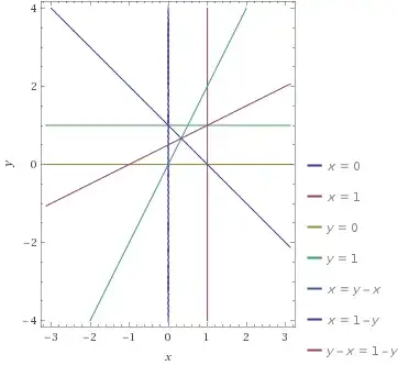

Another approach: multivariable. Let the cuts be $x,y$ from the left, $y>x$. Then the pieces are $x,\,y-x,\,1-y$. The desired expected value is then $2$ times $$\frac12 E=\iint\limits_{x>y-x\\x>1-y} x\,\mathrm{d}x\,\mathrm{d}y+ \iint\limits_{y-x>x\\y-x>1-y} (y-x)\,\mathrm{d}x\,\mathrm{d}y+ \iint\limits_{1-y>y-x\\1-y>x} (1-y)\,\mathrm{d}x\,\mathrm{d}y.$$ 2 $$\frac12 E= \left(\int\limits_{1/3}^1 \int\limits_{1-x}^{2x} -\int\limits_{1/2}^1 \int\limits_{1}^{2x} -\int\limits_{1/2}^1 \int\limits_{1-x}^{x}\right) x\,\mathrm{d}y\,\mathrm{d}x+\\ \left(\int\limits_{0}^{1/2}\int\limits_{2x}^{1}- \int\limits_{0}^{1/3}\int\limits_{2x}^{(x+1)/2}\right) (y-x)\,\mathrm{d}y\,\mathrm{d}x+\\ \left(\int\limits_{0}^{1/2}\int\limits_{x}^{1-x}- \int\limits_{0}^{1/3}\int\limits_{(1+x)/2}^{1-x}\right) (1-y)\,\mathrm{d}y\,\mathrm{d}x$$ It appears that it suffices to take only the first integral, the other should be equal by symmetry. $$\frac16 E= \int\limits_{1/3}^1 (3x-1)x\,\mathrm{d}x- \int\limits_{1/2}^1 (2x-1)x\,\mathrm{d}x- \int\limits_{1/2}^1 (2x-1)x\,\mathrm{d}x=\\ \frac{14}{27}-2\cdot \frac{5}{24}=\frac{11}{108}.$$
    I understand one part that expected value of largest part is (Exp length of first part when it is largest) + (Exp length of second part when it is largest) + (Exp length of third part when it is largest) is this correct reasoning, and also why is desired expected value two times this as in your answers first paragraph? – jeea Jul 30 '20 at 10:11
  • Because of $y>x$ is half of the square. It might be $y<x$ as well. I'd rather say "sum from 1 to 3 (Exp length of n-th part when it is largest)*(probability when the n-th part when it is largest)" – Alexey Burdin Jul 30 '20 at 10:15
  • So actually what exactly is $11/108$ – jeea Jul 30 '20 at 10:22
  • $1/3$ of $1/2$ of the desired expected value. – Alexey Burdin Jul 30 '20 at 10:25
  • Can I say that in my answer I have not considered the values added to expected value of largest part by the second and third pieces and by $y < x$ – jeea Jul 30 '20 at 10:29
  • Yes, this reasoning like "let $x>y$, then multiply by $2$, then assume $x$ is the largest and multiply by $3$ by symmerty" sounds correct to me. Btw, the picture in this answer is so cute/neat. Far more than mine. – Alexey Burdin Jul 30 '20 at 10:42
