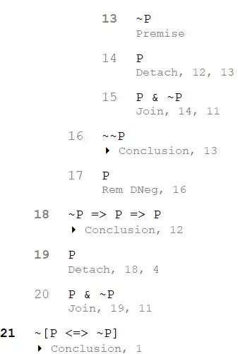

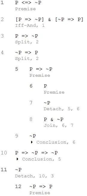

(Posted after answer accepted.) Using a form of natural deduction:
