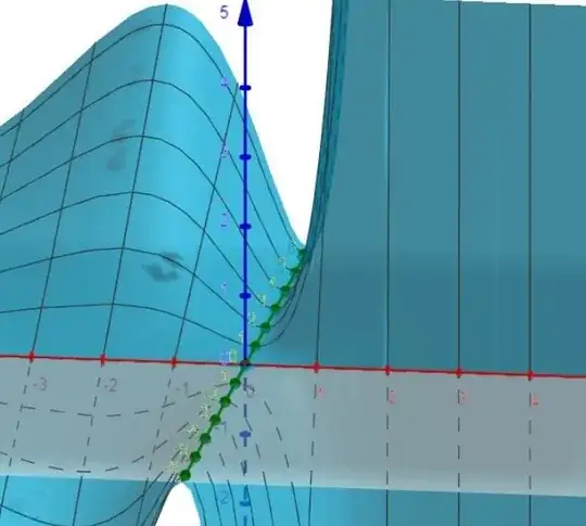

Graph of function : $$f(x,y)=x^2 y e^x$$
Plugging $y(x)=x^2 $ giving:
$$ f(x,y(x)) = x^2 e^x y(x)$$

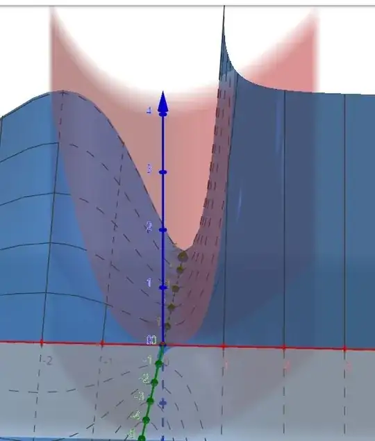

The curve $ y=x^2$ has been raised up along the $z$ axis giving the surface. The intersection of the red surface and the blue curve is the portion of the surface given when you plug in the equation of curve as input to the surface's equation.
