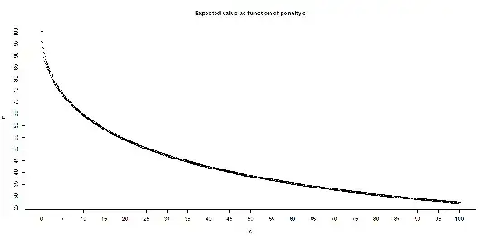

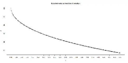

a few special cases for different penalties of c to throw 100-sided dice again, computed in R:
$$f <- function(x,c) {x^2 - (201+2*c)*x + 10100}$$
$$uniroot(f,c(1,100),tol=0.0001,c=0.1) => 96.08781$$ $$uniroot(f,c(1,100),tol=0.0001,c=0.5) => 90.95011$$ $$uniroot(f,c(1,100),tol=0.0001,c=1) => 87.27854$$ $$uniroot(f,c(1,100),tol=0.0001,c=2) => 82.34436$$ $$uniroot(f,c(1,100),tol=0.0001,c=3) => 78.75632$$ $$uniroot(f,c(1,100),tol=0.0001,c=5) => 73.40249$$ $$uniroot(f,c(1,100),tol=0.0001,c=10) => 64.56254$$
