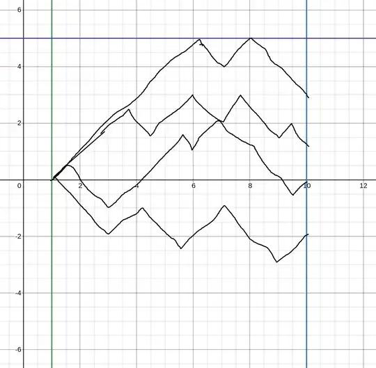

Here is an elementary argument: Let $M\in\mathbb N$. I claim that $$\sup_{m\ge M} S_m=\infty$$ almost surely. Note that it is enough to show that (why?) $$\mathsf P(\sup_{m\ge M} S_m\ge n)=1$$ for all $n\in\mathbb N$. Note that all the paths of $S$ are mountain ranges. So we look at all the mountain ranges (see this post for terminology) from $(M, -M)$ to $\{x+T\}\times\mathbb Z$ that always stay in the lattice $\mathbb Z\times\mathbb Z_{\le n}$ for some fixed $T\in\mathbb N$. There are, if my calculations are good (and if they are not, the idea is still very much the same; see the last application in the post here), $$\sum_{k=-r}^0\binom{T}{\left\lfloor\frac{T+r}2\right\rfloor+k}$$ such mountain ranges where $r=n+M.
From $\log$-convexity of the $\Gamma$-function (see my answer here), we have $$\sum_{k=-r}^0\binom{T}{\left\lfloor\frac{T+r}2\right\rfloor+k}\le (r+1) \frac{\Gamma(T+1)}{\Gamma(1+T/2)^2}.$$
From Stirling's approximation (not used carefully, the attentive reader should check my calculation), the latter term is asymptotically equivalent to $$\frac{\sqrt{2}(r+1)}{\sqrt{\pi T}} 2^T.$$
Now, the probability that $\sup_{m\in\{M,M+1,\dots, M+T\}} S_m \ge n$ is equal to the probability that $S_M\ge n$ or $\dots$ or $S_{M+T}\ge n$, which, since $S_M\ge -M$ almost surely, is at most (exercise: check this) $$2^{-T}\sum_{k=-r}^0\binom{T}{\left\lfloor\frac{T+r}2\right\rfloor+k}$$ where $r=M+n$. But the latter is, as we established, asymptotically at most $$\frac{\sqrt{2}(r+1)}{\sqrt{\pi T}}.$$ This converges to $0$ as $T\to\infty$, and therefore the probability that the limsup is finite is $0$.
Here are some mountain ranges not surpassing a $y$-axis-barrier:
