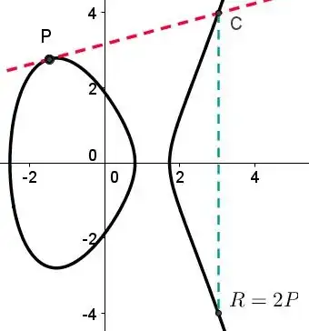

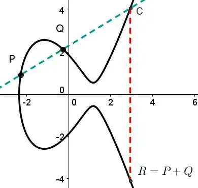

I was surprised to learn about the elliptic curve groups. You fix constants $a$ and $b$ take the set $S$ of points on the Riemann sphere (that is, the complex plane plus a point at infinity) of the form $$y^2 = x^3 + ax + b.$$ Then define the sum two points $p_1, p_2$ on this curve by taking the straight line through $p_1$ and $p_2$ and finding the third point $p_3 = \langle x_3, y_3\rangle$ where the line intersects $S$. Then $p_3^{-1} = \langle x_3, -y_3\rangle$ is the group sum of $p_1$ and $p_2$. It's not immediately clear that there is necessarily a point $p_3$, but there is, with suitable treatment of tangents and of the point at infinity. It's not immediately clear that the operation is associative, but it is. The point at infinity is the identity element, and the inverse of the point $\langle x, y\rangle$ is $\langle x, -y\rangle $.
add
double
epsilon
  • 1,786
MJD
  • 67,568
  • 43
  • 308
  • 617
  • 19
    +1. I think the existence of the third point on a line is not too tricky. Associativity, on the other hand, is a nightmare! (At least if you try to prove it just from this chord-and-tangent definition. As in other examples, there is an "obvious" group $\mathrm{Pic}^0$ lurking in the background, with a non-obvious bijection to the set $S$.) –  Apr 16 '13 at 16:18
    Notice that the elliptic curve group has a nice interpretation as to its group-properties: just map it to the complex torus, associated with some complex lattice, and show that the map is a homomorphism. So the mysterious operations on elliptic curves are just odinary ones on complex tori. I think this is not entirely anhistorical, as this approach could be traced back to Weierstraß, at least to the functions named after him. Even if this is not true, we can trace it back to the days of Euler, especially to the works of Fagnano. Regards. – awllower Apr 16 '13 at 16:26
    The sum of the two points $p_1$ and $p_2$ is not the third collinear point but rather its inverse. – John Bentin Apr 16 '13 at 20:22
  • I completely missed that, or I might not have mentioned it. Still I'm glad that I did, since I think it's a good addition to the CW. – MJD Apr 16 '13 at 21:33
    In fact Andrea Mori already had such an answer, but deleted it because elliptic curves were already mentioned in the question. – Martin Brandenburg Apr 17 '13 at 06:34
    I find it even less obvious that this works even if the components are finite fields instead of real numbers. – CodesInChaos Apr 18 '13 at 11:48
