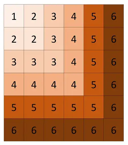

The simplest thing here is to view the problem graphically. For a pair of standard six-sided dice you can visualise the maximum value in a grid as shown below. You can see that the number of values of each number increases by the odd numbers --- $1, 3, 5, 7, ..., 11$. For dice with more sides, this pattern continues, with a longer series of odd numbers.
Using this pattern, we can see that for a pair of $w$-sided dice the expected value of the maximum roll is:
$$\begin{aligned} \mathbb{E}(M) = \sum_{m=1}^w m \cdot \frac{2m-1}{w^2} &= 1 \times \frac{1}{w^2} + 2 \times \frac{3}{w^2} + 3 \times \frac{5}{w^2} + \cdots + w \times \frac{2w-1}{w^2}. \\[6pt] \end{aligned}$$
Computing this expectation requires us to compute the sum of products of natural numbers and the corresponding odd numbers. The exact formula is:
$$\begin{aligned} \mathbb{E}(M) = \frac{1}{w^2} \sum_{m=1}^w m (2m-1) &= \frac{1}{w^2} \Bigg[ \frac{w(w+1)(2w+1)}{3} - \frac{w(w+1)}{2} \Bigg] \\[6pt] &= \frac{1}{w^2} \cdot \frac{2w(w+1)(2w+1)-3w(w+1)}{6} \\[6pt] &= \frac{1}{w^2} \cdot \frac{w(w+1)(4w-1)}{6} \\[6pt] &= \frac{(w+1)(4w-1)}{6w}. \\[6pt] &= \frac{4w + 3w-1}{6w}. \\[6pt] \end{aligned}$$
For a six-sided dice we have $w=6$ so that:
$$\mathbb{E}(M) = \frac{4 \cdot 6^2 + 3 \cdot 6 - 1}{6 \cdot 6} = \frac{144 + 18 - 1}{36} = \frac{161}{36} = 4.47 \bar{2}.$$
If you are looking for a quick-and-dirty approximation, you could approximate this sum by an integral:
$$\begin{aligned} \mathbb{E}(M) &\approx \int \limits_0^w m \cdot \frac{2m-1}{w^2} dm \\[6pt] &= \frac{1}{w^2} \int \limits_0^w (2m^2-m) dm \\[6pt] &= \frac{1}{w^2} \bigg[ \frac{2}{3} m^3 - \frac{1}{2} m^2 \bigg]_{m=0}^{m=w} \\[6pt] &= \frac{2}{3} w - \frac{1}{2} \\[6pt] &= \frac{4w^2-3w}{6w}. \\[6pt] \end{aligned}$$
This is quite close to the exact formula; only the last term in the formula is missing.
