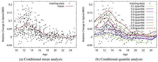

In addition to the previous answers, I want to highlight the differences in the solutions obtained when optimizing each of the two objective functions. In particular, if we look at the response variable $y$ conditioned on the explanatory variables $\mathbf{x}$, that is $y | \mathbf{x}$, the algorithm estimates
  • the mean of response values, in the case of squared differences;
  • the median of the response values, in the case of of absolute differences.
By replacing the absolute value with a tilted absolute value loss function, we obtain quantile regression. The figures below exemplify the differences in solutions for the two methods (these images were taken from this assignment, see §2):
The same resource provides some motivating examples for using quantile regression:
  • A device manufacturer may wish to know what are the 10% and 90% quantiles for some feature of the production process, so as to tailor the process to cover 80% of the devices produced.
  • For risk management and regulatory reporting purposes, a bank may need to estimate a lower bound on the changes in the value of its portfolio which will hold with high probability.
