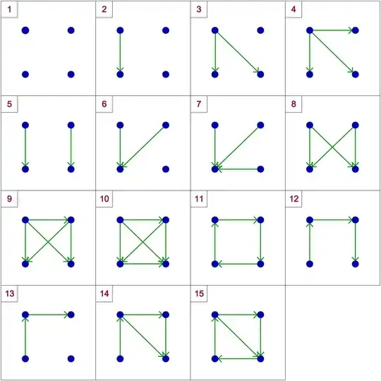

Edit: Here is what I have thus far with my current understanding: enter image description here

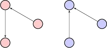

In the following example, the two red digraphs have essentially the same digraph: there is one node with two out-edges. An edge-preserving bijection (i.e., an isomorphism) in this case is $1 \mapsto 2$, $2 \mapsto 1$ and $3 \mapsto 3$.
Examples of isomorphic/non-isomorphic digraphs on 3 nodes
There is no such bijection between the red and blue digraphs since they do not have the same in/out-degree sequences.

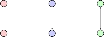

The non-isomorphic digraphs on 2 nodes
The number of digraphs grows quickly, and is given by Sloane's A000273. For $2$-, $3$- and $4$-node digraphs, the numbers are $3$, $16$, and $218$, respectively (allowing bidirectional edges).

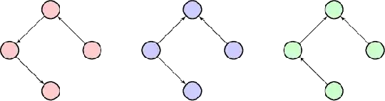

There can be, here's an example:
Non-isomorphic digraphs with the same in-degree and out-degree sequences
and one without bidirectional edges:
In the table in the question there's a number of omissions (this is why I'd do it on a computer).
You've correctly observe e.g. that:

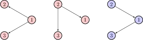

Two non-isomorphic digraphs on 3 nodes
are not isomorphic, since the in/out-degrees don't match. For the same reason e.g.:

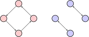

Three non-isomorphic digraphs on 4 nodes
are also non-isomorphic. Similar omissions (where we flip edge directions) happen in other cases.

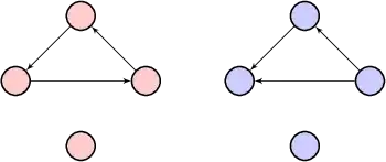

I also don't see a oriented 3-cycles with an isolated vertex.
Omissions from the list

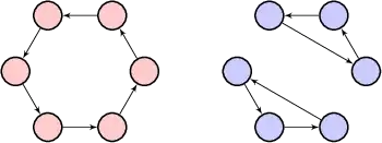

    In the case where bidirectional edges are not allowed, the sequence is Sloane's A001174; and the directed $6$-cycle and the union of two disjoint directed $3$-cycles have the same in/out-degree sequence. – Douglas S. Stones Apr 07 '13 at 20:27
