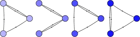

Then I wrote a script to print them, giving the 48 digraphs drawn below:
For 4-vertex 4-edge digraphs, we get these four:
This agrees with Marko Riedel's answer in these cases.

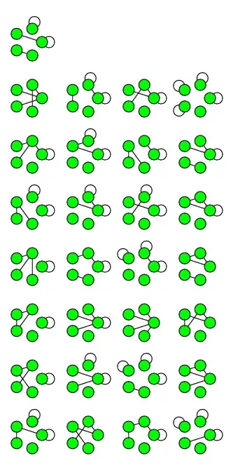

The following Maple code uses Maple and PostScript to produce a diagram of the $29$ unique graphs with self-loops on five vertices having four edges. The image is shown below.

graphs with loops on five vertices with four edges under isomorphism
