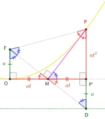

Here's a picture of the situation (rotated by $90^\circ$), from which, as a bonus, we may deduce the parabola-ness of the curve from the parameterization (without relying on "knowing" it corresponds to $y=\frac{1}{4a}x^2$):
Point $F$ (the parabola's ostensible focus) is $a$ units "up" from origin $O$. Point $P$ is parameterized by $P=(2at,at^2)$, so $|OP'|=2at$ and $|PP'|=at^2$. Let $M$ be the midpoint of $\overline{OP'}$, and let $D$ be the point where the extension of $\overline{PP'}$ meets the ostensible directrix $a$ units "down" from $O$.
Clearly, $\triangle OFM\cong\triangle P'DM$. Also, $\triangle OFM\sim\triangle P'MP$ by the key proportionality of corresponding sides $$\frac{|OM|}{|OF|}=\frac{at}{a}=t=\frac{at^2}{at}=\frac{|PP'|}{|MP'|} \tag{1}$$ But, then $\triangle MFP$ must be a right triangle whose legs are in the same proportion $$\frac{|MP|}{|MF|}=t \tag{2}$$ so that $\angle MFP\cong\angle OFM\cong\angle MDP$, and we deduce $\overline{PF}\cong\overline{PD}$: therefore, $P$ lies on the parabola with focus $F$ and directrix through $D$. $\square$
To the question at hand ... By the Reflection Property of Parabolas, the bisector of $\angle FPD$ is tangent to the parabola at $P$. Thus, $\overleftrightarrow{MP}$ is a tangent line, and right-hand half $(1)$ shows that $t$ is its slope. (This is consistent with @mathlove's comment and @ChiefVS's answer that, in the original horizontally-opening context, the slope of the tangent is $1/t$.)
Of course, the left-hand half of $(1)$, as well as $(2)$, give other interpretations of $t$.

  • Thank you for your answer. A minor issue: May I know the reason for using "$\cong$" over "$=$" for the equality of angles below equation $(2)$ (so far I have used it only for congruence)? Further, which GeoGebra platform do you use to make such beautiful diagrams - Graphing calculator, Geometry or GeoGebra classic? – Vishnu Feb 13 '20 at 14:47
    @GuruVishnu: Formally, "$\cong$" is for objects (segments, angles, triangles, etc) and "$=$" is for values (lengths, measures, areas, etc). So, I write "$\angle A\cong\angle B$", but "$m\angle A=m\angle B$". ... Actually, with angles, I tend to be a little informal, because the "$m$" looks like multiplication, so I'm perfectly happy writing things like "$\angle A=90^\circ$" and "$\angle A=2\angle B$" and "$\angle A=\angle B-\angle C$". Even so, when comparing one angle to another directly, I tend to favor "$\angle A\cong\angle B$" over "$\angle A=\angle B$". – Blue Feb 13 '20 at 15:46
    @GuruVishnu: I use the desktop GeoGebra Classic (5.0.x) for the Mac. ... As an app maker and user interface stickler, I'm not terribly fond of the Calculator and Geometry apps on the desktop; they are more "modern", but they look and act like wrappers for their web-apps. That's efficient for their developers, but unsatisfying for their users like me. Even the cross-platform, Java-based Classic is annoyingly non-native, but I'm stuck with it ... until I write my own alternative. ;) ... I complain, but the app helps me make "beautiful diagrams" (thanks for that! :), so I'm pretty happy. – Blue Feb 13 '20 at 16:07
