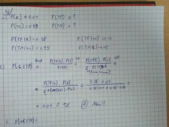

1) I should summarize the above in terms on probabilities. That is my solution: P(C) = 0.01; P(not C) = 0.99 P(TP|C) = 0.98; P(TN|not C) = 0.95
2) A patient gets tested, and the test is positive. Do we tell this patient, he has cancer? I calculated P(C|TP) and got a solution value = 0.01 being 1%. Which means for me, we don't tell him, as there is only 1% chance, that he has cancer.
3) The patient gets testet again! Both tests are independent to each other. And i should calculate the "posterior probability" of cancer and not cancer following the two tests.
And here, for 3) i am lost a bit. I would now calculate just P(not C|TP) as i did in 2). But is that actually correct? If not, what should i calculate instead and how?
Task itself Try of Task

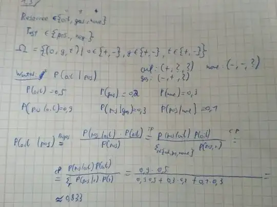

And for reference, a similar excercise, we discussed. The solutions are said to be correct for the next 2 pictures. I was trying to apply the same methods. But for Task 3) i am unsure, how to solve it.
example Solution for example
You can tell without any calculation that your answer to $2)$ is wrong because the posterior probability is equal to the prior probability, and the test is clearly not so bad as to be completely irrelevant.
For $3)$, you need to calculate $P(\text{no cancer}\mid\text{test $1$ positive}\cap\text{test $2$ positive})$, where e.g. $P(\text{test $1$ positive}\cap\text{test $2$ positive}\mid\text{cancer})=P(\text{TP}\mid\text{C})^2$.

  • Yes, thanks. So, you said, my probabilities are the same. Is at least my P(C|TP) = 0.01 correct? That means, that P(C) = P(C|TP) right? Maybe i did calculate the wrong thing in a whole? I just dont understand, why you say, the test is good, if it only gets correct in 1% of all cases. Probability a patient has cancer given the test is positve. That is, what i calculated. And according to the excercise, i think that is, what i should do. "new patient => Test lab is positive => should we tell him, he has cancer?" And if the probability is only 1%, that he has cancer, if the test is correct ... – user3556093 Jan 09 '20 at 12:59

  • @user3556093: I didn't say that the test is good if it's only correct in $1%$ of cases – I said that that result must be wrong because it would mean that the test is completely irrelevant (since $1%$ is already the a priori probability of having cancer, without a positive test result), whereas it's clearly not completely irrelevant – not based on your erroneous result but based on the given data, which show that there's a high correlation between the test results and having cancer. – joriki Jan 09 '20 at 14:24
  • @user3556093: The error in your calculation is where you have $0.95\cdot0.99$ in the denominator. This should be $P(\text{TP}\mid\neg\text C)P(\neg\text C)=0.02\cdot0.99$. – joriki Jan 09 '20 at 14:26
  • @user3556093: As to your last question above: The probability for two independent events to both occur is the product of their probabilities; in fact, this is the definition of independence. – joriki Jan 09 '20 at 14:28
  • Ah, i think i found the error you were mentioning. I now get a result of 33% for P(C|TP). Which i still think is not very good. Or am i wrong again? I also still don't understand task 3 and why i have to calculate P(no cancer∣test 1 positive∩test 2 positive). Do i also have to calculate P(cancer∣test 1 positive∩test 2 positive)? It says so, or can i just do it with 1- P(no cancer∣test 1 positive∩test 2 positive)? – user3556093 Jan 12 '20 at 09:24
  • @user3556093: Yes, conditional probabilities are probabilities, $P(A\mid C)=1-P(\overline A\mid C)$ holds just like $P(A)=1-P(\overline A)$. About $33%$: I'm sorry, I made a mistake above. It's right that you need $P(\text{TP}\mid\neg\text C)P(\neg\text C)$ there, but $P(\text{TP}\mid\neg\text C)=1-P(\text{TN}\mid\neg\text C)=1-0.95=0.05$. I'd calculated $1-P(\text{TP}\mid C)=1-0.98=0.02$ by mistake, which is $P(\text{TN}\mid C)$, not $P(\text{TP}\mid\neg\text C)$. About task $3)$: Can you say more about what's causing you difficulties? It's really essentially just the multiplication rule. – joriki Jan 12 '20 at 11:40
  • So is the solution 33% correct? Or not? My current Solution is: (0.980.01/(0.980.01+0.02*0.99)) = 0,33 %. Or were the 1% correct? I am super confused now. For 3) I have difficulties to understand, what exactly i have to calculate, and why it has to be what you said. Seems to be a very basic thing, i just dont get. We never have done such an exercise, so i have no solution which i could try to understand and compare. Thus i am completely lost and do not understand anything, regarding 3) Nor what i have to do, neither what you suggest to do to obtain the correct solution. – user3556093 Jan 16 '20 at 09:39
  • Edit: 0.33, not 0.33 %. Why is P(TN|C) = 0.02? I thought it is 0.05. P(TN|¬C) = 0.95. So shouldn't P(TN|C) be 0.05? Same with P(TP|C) is 0.98. So P(TP|¬C) should be 0.02, or not? P(TN|C) was given in the text: (Test returns positve AND cancer is actually present is 98%. Test is negative in only 95% where disease is NOT present) This is in the text. So did i calculate P(TP|¬C) and P(TN|C) wrong? If so, what would be correct, and why? Again, thank you for your help :) – user3556093 Jan 16 '20 at 09:46
