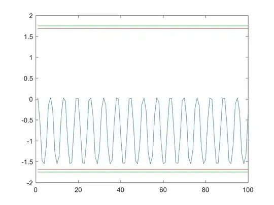

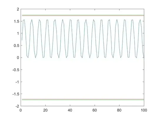

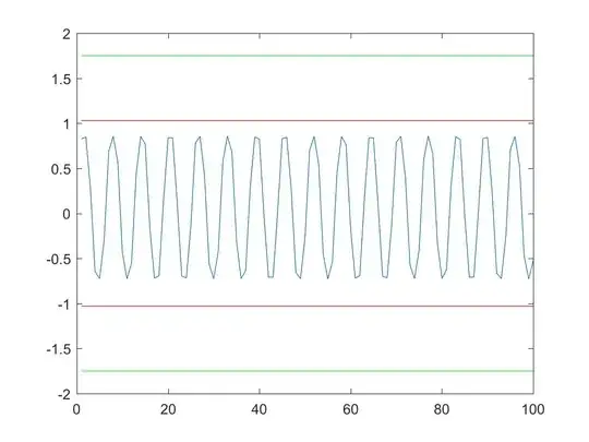

Here are some example figures, where $\pm M(\phi)$ in red, $\pm M^*$ in green, $S_n$ for $n=1 \cdots 100$ in blue (plotted as a continuous graph).
Fig.1: $\phi=0$. enter image description here
Fig.2: $\phi=1$. enter image description here
Fig.3: $\phi=2$. enter image description here
