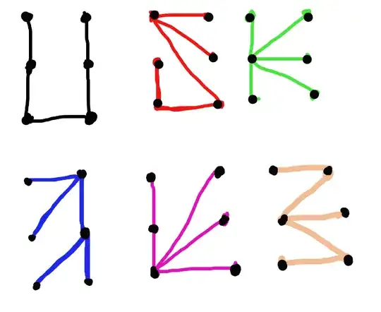

$(2)\:$Draw all non-isomorphic, cycle free, connected graphs having six vertices.

I tried for $(2)$ and got $6$ case$(\text{Sorry for my poor drawing})$, enter image description here
I think the main hack will be to find all possible tree.
