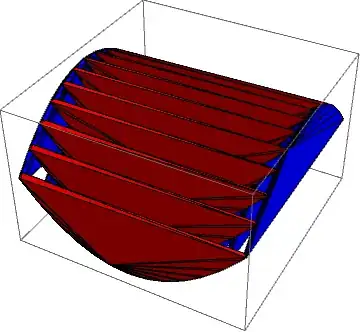

Now I'm going to handwave a bit because there's no good way to draw pictures of the result, though I'll try anyway. To get the polyhedral complex, we do the following:
  1. At each contact point between a red pipe and a blue pipe, put down a polygon where that red pipe and blue pipe are supposed to "meet".
  2. Replace each red pipe by the convex hull of all the polygons where it meets blue pipes. Do the same (vice versa) for each blue pipe.
Here's a picture, though it's not as helpful:
The idea is that because all the contact points of a red pipe are in convex position bending upward, taking the convex hull will give us a bunch of points that stay above the surface $z = x^2-y^2$; for blue convex hulls, we'll get a bunch of points that stay below that surface, so we don't create any inconvenient intersections. Taking convex hulls won't interfere with the contact polygons between the red objects and the blue objects.
