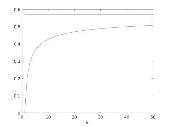

I've plotted Equation 1 for various $k$. My results seem to indicate that the expression above is plausibly true. Beyond $k=50$ I run into floating point issues in the numerical calculation, and series is not computable.

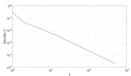

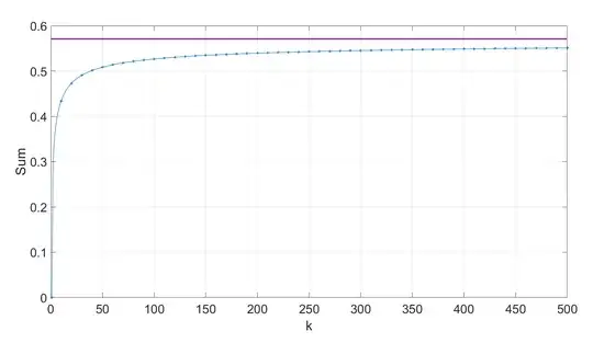

Here is the sum evaluated to 500 as well as a plot of the difference between successive terms, FYI.
HTH

With regard to @user3113647's plots, we then have $$S(k)-S(k-1)=\frac{1}{8} \sqrt{\pi } \left(\frac{1}{k}\right)^{3/2}+O\left(\frac{1}{k^{7/2}}\right)$$ and then a slope of $-\frac 32$ in the logarithmic scale.
