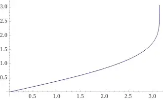

Shown is the $0\le M\le \pi$ case:
$\text I^{-1}_s\left(\frac52,\frac12\right)$ reduces the problem to a student T distribution quantile of $v=5$ degrees of freedom.
