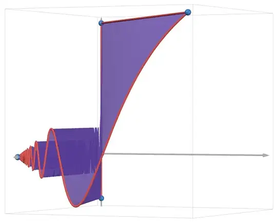

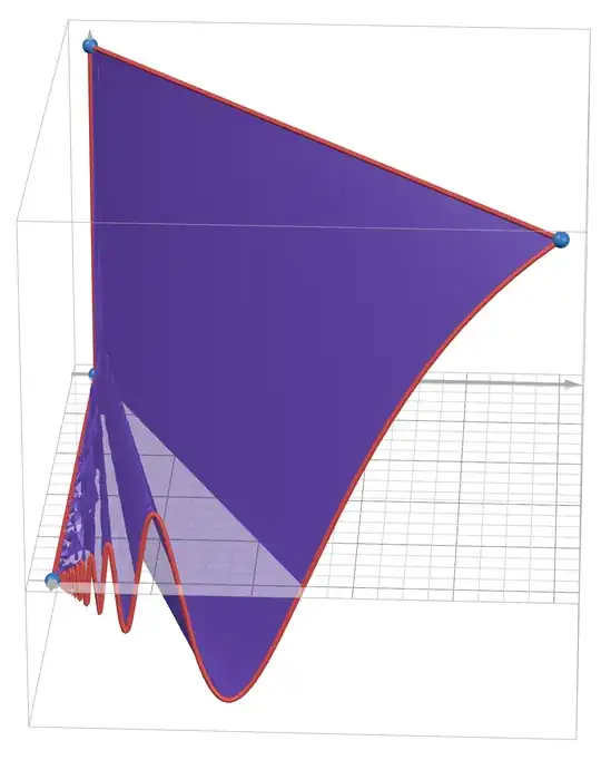

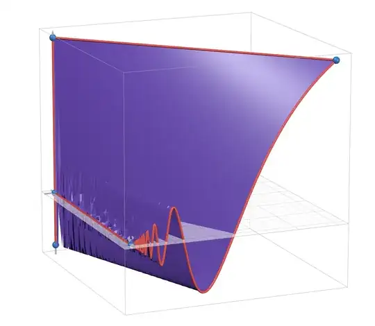

Not every CW complex is homeomorphic to a simplicial complex. See this MathOverflow question and its answers. There, Evan Jenkins mentions the book Cellular Structures in Topology by Fritsch and Piccinini, which contains the following example in section 3.4. I've made a graph in Desmos 3D for easier visualization, with screenshots below.
The CW complex has five 0-cells (blue), five 1-cells (red), and one 2-cell (purple). The 1-skeleton as a graph is isomorphic to a square with an extra edge hanging off, but the attaching map of the 2-cell is infinitely wiggly, specifically on that extra edge.
The proof that this is not triangulizable (i.e. homeomorphic to a simplicial complex) goes roughly like this:
  • It's compact so any triangulation would have to be finite.
  • No point on the $z$-axis in interior to a 2-simplex.
  • At each local maximum level of the surface, the point of the on $z$-axis must be a 0-simplex: if it were interior to a 1-simplex, then other nearby points would have homeomorphic neighborhoods to that local-maximum-level point. But this is not the case: neighborhoods of the local-maximum-level points ("tops of folds") do not look like neighborhoods of their close neighbors.
  • There are infinitely many such maximum levels, so infinitely many 0-simplices, so there's no finite triangulation.
In the images below, note that the rough texture moving along the $x$-axis is just from limited rendering; the only real "roughness" is the waviness from the wavy constant-$x$ cross-sections, and the "pinching" at the $z$-axis.
Desmos 3D graph of "z=f(y/x) where f(t)=t*sin(pi/(2t)) A second screenshot of the same 3D graph A third screenshot of the sane 3D graph
