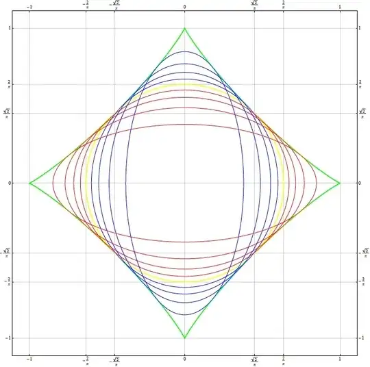

  • Isoperimetric ellipses (see more on the link here):
$$x^2+\frac{y^2}{1-\color{red}{k}^2}= \left[ \frac{p}{4E(\color{red}{k})} \right]^2$$
$$\frac{x^2}{1-\color{red}{k}^2}+y^2= \left[ \frac{p}{4E(\color{red}{k})} \right]^2$$
